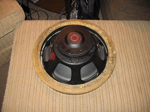

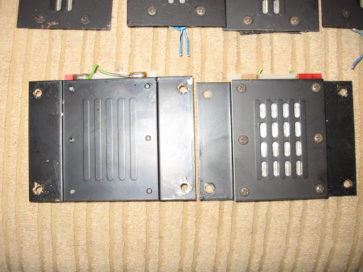

so...i picked up the QLS1 parts in green bay this weekend. the seller, who was very helpful and knowledgeable, helped me completely strip the speakers of everything useful, including the rear EMIT grills and the wood bases with the crossovers. i couldn't take the cabs, i couldn't find someone else to take the cabs, and he was going to get rid of them immediately, so i figured what the heck. it was sad to see the demolition of a giant, but on the bright side i'll be able to refurb one set of crossovers while i still get to enjoy the speakers.
9 full-line EMITS measure good, 3 measure >8 Ohms, and 4 measure open. both rears are good. 6 or 7 of the midrange domes are still intact. the woofers both measure about 2.5 Ohms/5.4 Ohms. here are the EMITs:
for some reason, i had really thought the rear EMITs were just the half-line version found on the smaller quantum speakers, but not so. don't believe i've ever seen a pic of these before:

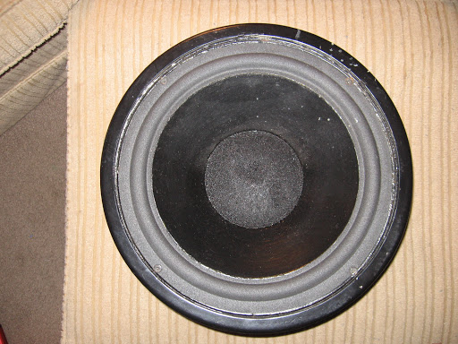

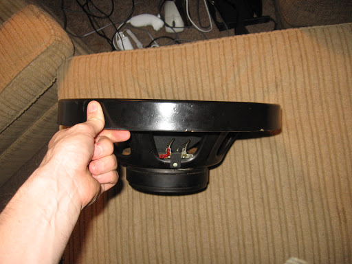

the woofers are interesting too. now, his pair of QLS1s with the raised black particleboard baffle were definitely a different version than mine, which have the flush walnut baffle. the weirdest thing to me was the thick particleboard woofer gasket that the woofer basket is very solidly glued to - was this stock? he mentioned that the woofers had been "reconed," which can often mean just "refoamed," which these definitely have been. the cones are stamped in white with "776895." the cone looks original to me, does anyone recognize that #?
That is truly awesome! Give Murphy's oil soap on the wood to start with. It can remove a huge amount of soil with little work.
And post more pictures please. Oh, I see you did. What a find!
