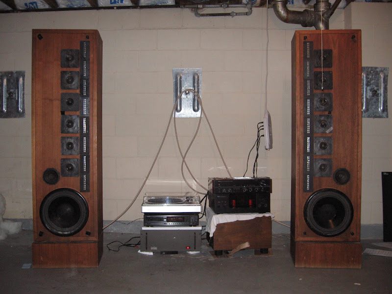

i finally got them put back together for enjoyment while i do the crossover work. i am missing two working midranges on the top left, but they're not really noticeable when you're sitting. and you really have to be sitting or standing at a pretty good distance for them to sound right. the midbass couplers put out so much of the music, but they're placed low and their dispersal pattern is not ideal since they're regular cones.
they sound really good. they're surprising delicate, and they don't sound "big" which is a good thing. the bass is tight as heck and as deep as you hear about. i'm impressed by female vocals and the accuract of piano reproduction. this is also the maiden voyage of my Denon DCD-1500II, and despite some problems reading certain CD-Rs and several other discs, i'm very happy with it. definitely seems to be an improvement in musicality over my ES changer, and i never noticed anything obviously lacking with that player.
here's a pic i just took. forgive the messiness of the basement setup, i just threw it together. i'm using styrofoam for damping on the left. i'm going to experiment with moving the speakers further apart, as you can see in the background that i have plenty of wire left. i actually made some DIY cables in a jiffy for the woofers out of 18 Ga. solid copper wiring that i twisted for easier placement - my other decent wire is being used upstairs and wasn't handy. not sure how the DIY stuff is working, i'll do some A/B-ing at some point.
Awesome to see another happy QLS-1 owner. I have had mine for 31 years (youch) and they look like the day I bought them. You're right they are "a little" boxy but I just love the sound and don't know that I could get rid of them. Besides what to replace them with, similar specs today are just out of site $$.
Dang those things are huge :D
We're gonna have to plan another Saturday me thinks so I can get an earful of those big muthas once you get them done :yes:
Glad to hear you like em so far Chris :thmbsp:
