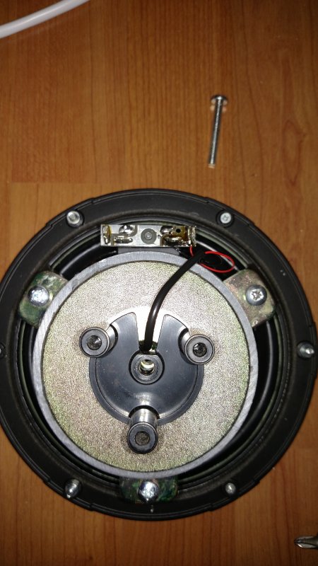

THE MISSION:
Having purchased a pair of KEF 103/4s about a month ago - I have set off to tear the things to pieces and get it back to peak running condition. The previous owner had done a fine job refoaming the internal bass woofers - but there is work yet to do. One tweeter sounded 'OK' at best - the other was so quiet, it was practically a paperweight.
These tweeters are notorious for having issues caused by dried ferrofluid. This magnetic fluid was used to cool the voice coil and improve power handling - but over time, turns to a sludgy paste that impedes the performance of the coil. My goal was to replace this fluid and restore the tweeters.
The double-edged sword (that I didn't find out until I got the damn things open) - is that the dried ferrofluid grips onto the voice coil - making it harder to extract. While opening one, the coil was no longer attached to the diaphragm itself - which I believe accounts for the lack of output I had seen. The second unit's voice coil was stuck in the sludge - which I believe stressed the adhesives connecting it to the diaphragm. Lastly - the glue that is inserted into the little notches held the diaphragm firmly to the cosmetic dome shield on the outside - so separating the dome took the diaphragm with it. Had the ferrofluid not separated them - that would have.
NT25 tweeters are no longer in production - spare parts just don't exist. So repair is my primary option.
THE QUESTION:
Would one use speaker-grade black rubber cement to adhere the voice coil to the diaphragm?
I ask this because every diaphragm I see online has the coil directly attached - and when I press down (gently) on the diaphragm while suspended over the coil (while running), the sound is full and bright. I believe the answer is yes - but it never hurts to ask before doing something potentially stupid.
Were I to do this, I would line up the coil and diaphragm - determine the points where they meet - and put four dots of the rubber cement on the coil and diaphragm respectively - and place them together with the cement points alternating. I bought the white speaker repair glue from parts-express, but I don't know if this has the tack-factor to last in this kind of application.

Good write-up and photos. I have used an epoxy to make a similar repair in the past, however this was on inexpensive speakers so I your case I'd do plenty of research. My understanding is that you need a rigid connection that doesn't damp any of the rapid movements of a high frequency driver. So I think you need to consider material type, rigidity and temperature resistance for your glue.
Also I'm not sure why you only want to use a few points of contact, unless that replicates the original bond.

All good points - I knew posting here was the right idea.
You make a valid point - I was under the impression that greater elasticity (ie - rubber cement) would be more resilient to the vibrations from the voice coil. But that would obviously impede and insulate the vibrations of the coil from the diaphragm, thus causing a frequence response dampening effect?
I'm no audio engineer - just trying to common-sense my way through this. Learning a lot, though!
Replaced the ferrofluid a few days ago - and posted asking for advice regarding the diaphragms.
I ended up using rubber cement - both for its tackiness, cure time, and flexible (but stiff) hold. Time will tell if this was the right choice, but I was unsure about epoxy.
I used a toothpick to apply a thin ring of glue around the upper edges (inside and out) of the voice coil - and lined it up with the diaphragm taped to the ring with masking tape. Then just sandwiched them together with my fingers.
Now both tweeters sound incredible. Took one from 'OK' to marvelous, and brought the other back from the brink of death (detached voice coil caused it to output a fraction of what it should).

At home depot waiting for my wife. But here's the basics.
Remove the crossover board by removing the 8-or-so screws on the fear.
After removing the screws, push the crossover up, and pull it out bottom-first.
Remove the HF and MF terminal connectors, and rest the crossover on the top of the unit, circuit board facing down. (My LF wires were long enough to allow for that).
Remove the batting and remove the three screws on the metal bowl on the inside of the unit connecting to the mid driver. Keep your hand on the front of the woofer frame to keep it from falling out, though very unlikely.
Once removed - pull the woofer out and remove the MF and HF terminals. And then set the woofer down on a flat surface. Because the foam surrounds do not protrude past the plastic ring - I set them face down.
De-solder the two wires running to the HF terminals running from the center of the driver - these are the tweeter leads.
Then remove the three large silver screws surrounding the driver - turning each one a full turn in sequence. Do not remove them one by one - give each a turn. Otherwise I've seen the magnet go all cockeyed as it gets caught on a screw.
Once those are removed - lift the maget straight up off the woofer cone - the tweeter will need to clear the voice coil - be gentle.
Then remove the screw holding the tweeter to the magnet (on the black plastic)
Then gently remove the tweeter from the magnet - pulling the leads back through
