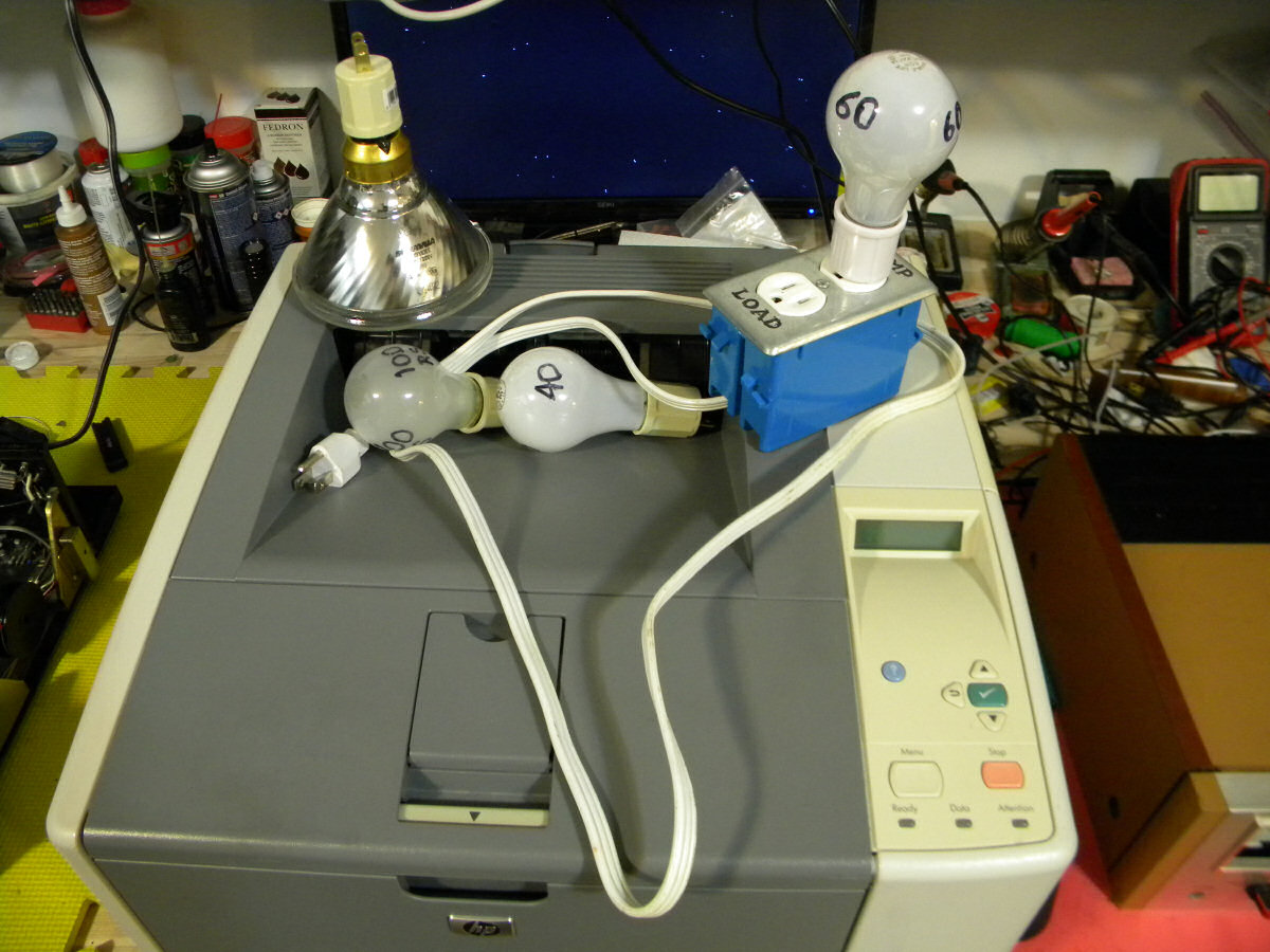

Also - after you perform the repair, do the initial power-up connected to the dim bulb tester you haven't built yet!
The economical way to construct a DBT is with a few inexpensive hardware store items:
http://audiokarma.org/forums/index.php?threads/i-would-like-to-attempt-to-fix-my-sansui.512012/#post-6656998
It ends up looking a little like this:
Incidentally, the printer is optional, and REALLY drives up the cost of the DBT.

Good morning all, I have replaced the parts mentioned above and I connected the unit to my DBT and turned it on - the 60W bulb stays bright, the relay inside the amp does not click and so I shut the unit off. I tried powering up a second time, this time waiting 5 seconds and the bulb does not dim so I powered off the amp and I need to figure out what is causing the current drain. I need some assistance, looks like I will be re-checking my connections for any mistakes, but I am fairly sure things are what they are supposed to be. The NTE 373 and 374 transistors have a metal case on the back - I assumed is for heat sync purposes and the old units did not have that. The pin connections are the same as the originals for all subs I mentioned above. Even if I were to have made a mistake with that I would not expect the amp to draw so much current but not to power up. Will someone please make some recommendations as to where to start? I don't want to blow any of the new parts, they were expensive. Thanks so much.
I would suggest installing a 100W lamp in your DBT and briefly apply power to see if the power supply is happier. 60W is fairly light as a DBT supply for a 60WPC amplifier.
