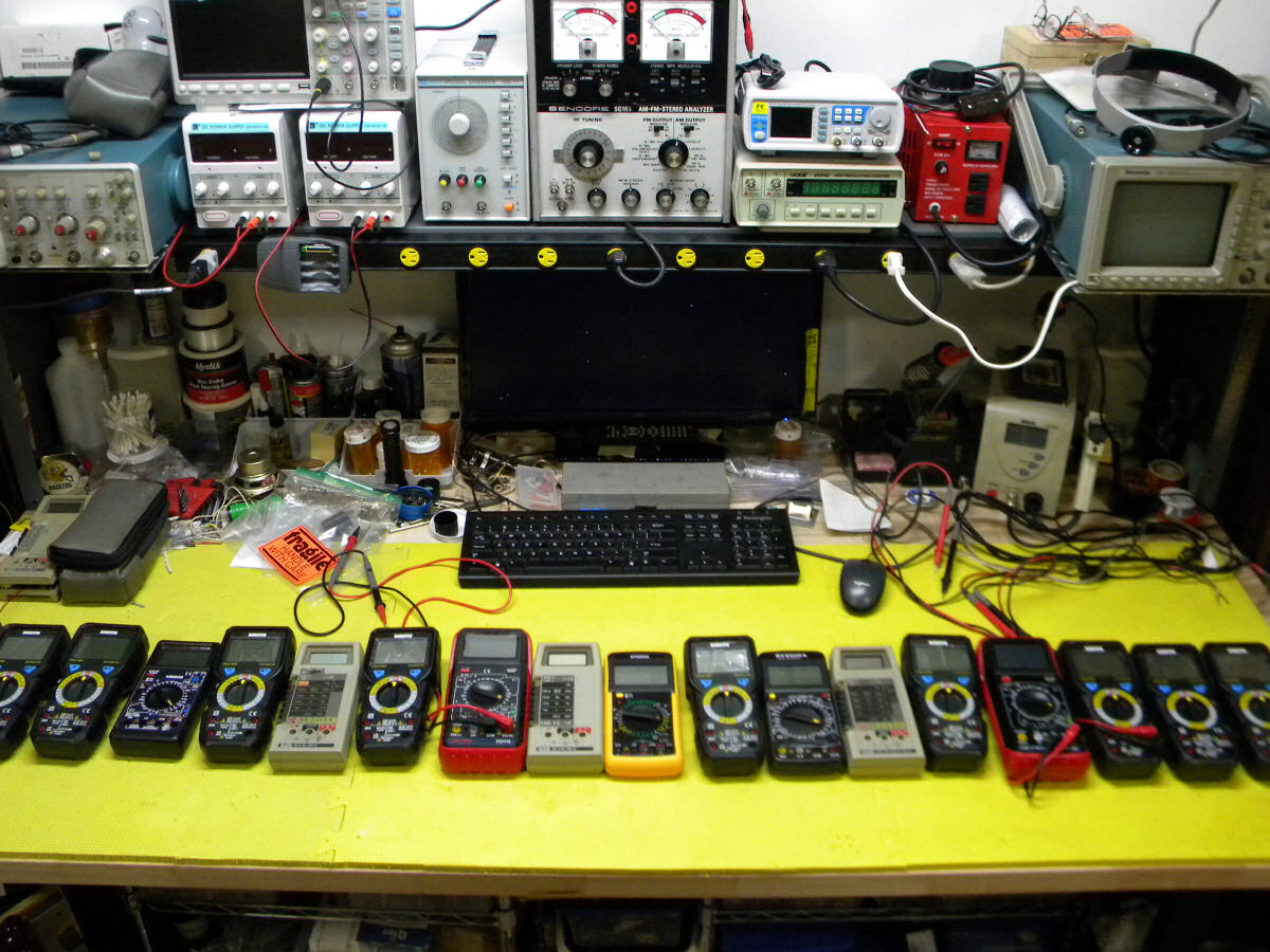

That meter should be sufficient for most work. FWIW, if you're ever shopping for a low-cost (throw-away type) meter, I've recently become involved in informal testing a variety of imported units with varying levels of features and specifications. Of all of them I tested for function, accuracy, repeatability, and linearity, for voltage resistance, current, capacitance, frequency, etcetera, one type stood out above the others.
Coincidentally, after the review reports went in, almost all the importing sellers of the "top" unit pulled their offerings at eBay and returned to the listings with the same units at nearly double the price. I'm pretty confident they all compare notes and watch the market price closely. They have since started to drop again (competition) but are not yet back in the "throw-away" price range.
The 830- and 9205-based meters were the lowest of those tested. The 9508- and 409-based meters were better, with a few types scattered between. The 890 (D series and above) were among the best tested. Of those, one stood out as having the best safety features, functions, and construction. That's the one whose price doubled in a day. I'm not going to do any endorsement or review here, but when these were well under $20 they were a steal (by comparison), but even at that you're STILL probably better off with an older/used Fluke which may be slightly out of cal:
Ha! Be careful with that level of power. I have the older rat-shack meter because it was the best I could afford at the time, and I needed it same day for a project (I miss that aspect of Radio Shack, being able to pick up components on the way home.) It may be time to consider biting the bullet on a higher end meter.
