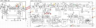

Quick Alignment question on a Kenwood KR-6200. The SM has me injecting the sweep signal at TP1 and pulling the signal at TP2, adjusting La7 and Lb1 for best IF waveform. This doesn't really make any sense since TP2 pulls the signal before it gets to Lb1 and on my board, all of the components associated with TP2 are not installed (red X's on the photo). It seems to me that I should be pulling the IF signal from point 'A' to adjust La7 and point 'B' to adjust Lb1 or just point 'B' to adjust both. Any thoughts?

Looking through a thread that @Ylli was helping on for a KR-5200 with same IF & MPX boards, I've discovered that the gate signal on pin 8 of the MPX board stays high when switching from no signal to a strong stereo signal --> 2.25V strong signal, 2.0V weak signal. That would steer me back to the IF board and circuit feeding pin 10 (pin 8 on the MPX board)
Some odd findings:
- Voltages shown in purple are for a strong stereo signal
- When I measure voltage at the orange point, I read 0VDC (probably an AC signal) but the voltage on pin 10 drops to 0.3V
- when I measure voltage at the red point, I read 12.6V but the voltage on pin 10 drops to 1.8V
- How does a 10 Mohm DMM affect the voltage on pin 10 when probing the circuit??
OK. Solved my own problem. I went back through the alignment to make sure I didn't miss anything and rechecked all the transistors and diodes on both boards - all tested good with a DMM/Diode test. I started checking voltages, although there aren't too many listed on the schematic and they seemed reasonable except for Q2 and Q3 on the MPX board were a little high or low. It wasn't until i figured out that the voltage reading shown in boxes on the schematic are actually AC voltages that the problem jumped out. In input was right around 150mVAC but the others were all over the place. Replaced Q1 - Q3 and all is right with the world again. Finished up the alignment and it sounds great. Time to clean up the faceplate and button it up.
