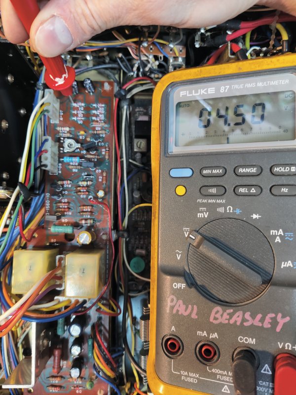

When I power up the unit with a current limited variac, I get no speaker protection relay click. After checking the relays with an power supply and verifying they work, I checked all other voltages I could and only found one thing out of place. Reading through the service manual on page 51 it states that if the center potential of the power transistors isn't at 0 volts, the diodes will detect the voltage and basically shut down the unit.
From what I can tell, the Diodes "read" this voltage from pins 6 & 7 which lead directly to the main Amp Board. These leads are reading ~4.5 volts on my unit, the diode array on the protection board is reading the same voltage.
Am I correct is thinking that there should be 0 volts coming from these pins? Is it this voltage that is turning on Qp3 and keeping the relays from operating?

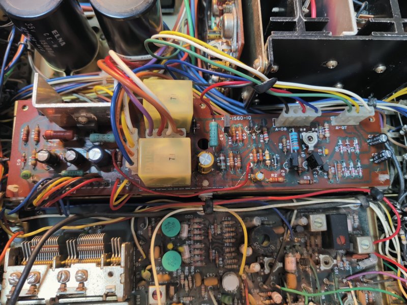

A-09 on the Protection Board? I have readings of the following:
Pin 1 = 0.110 v
Pin 2 = 0.052 v
Pin 3 = -0.012v
Pin 4 = 0.055 v
Not exactly 0 volts, is there adjustment for this or does it indicate something elsewhere?

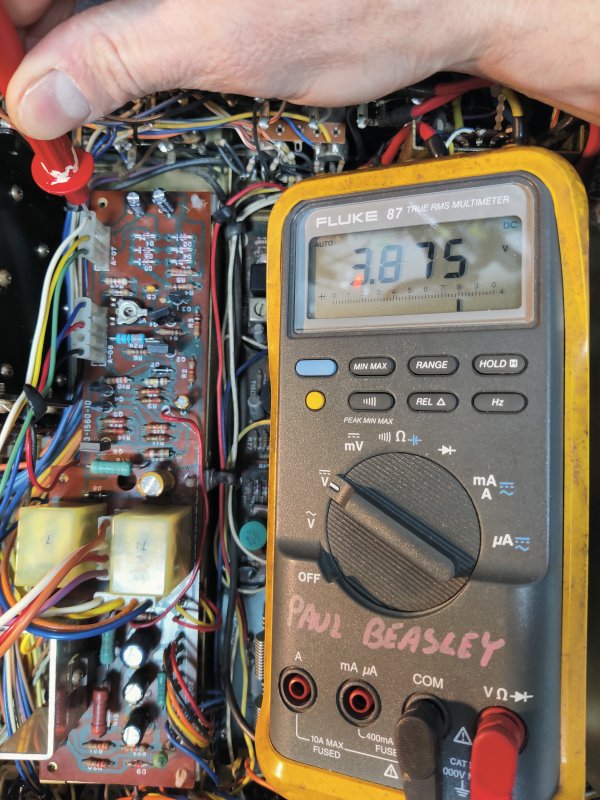

Both pins 9 and 30 on the main amp board have ~3.87 volts.
Again, I assume this voltage should be 0 volts. I've tried tracing this voltage throughout the main amp board and all components test fine. No bad resistors, I've replaced all electrolytic caps, and tested all transistors for shorts. Everything looks great.

**SOLVED** On the protection board I installed Q2 (2SA1220) backwards. Re-installed in the correct orientation and now it works perfectly.
Watch those pin-outs everyone! I feel so silly and so relieved at the same time.
