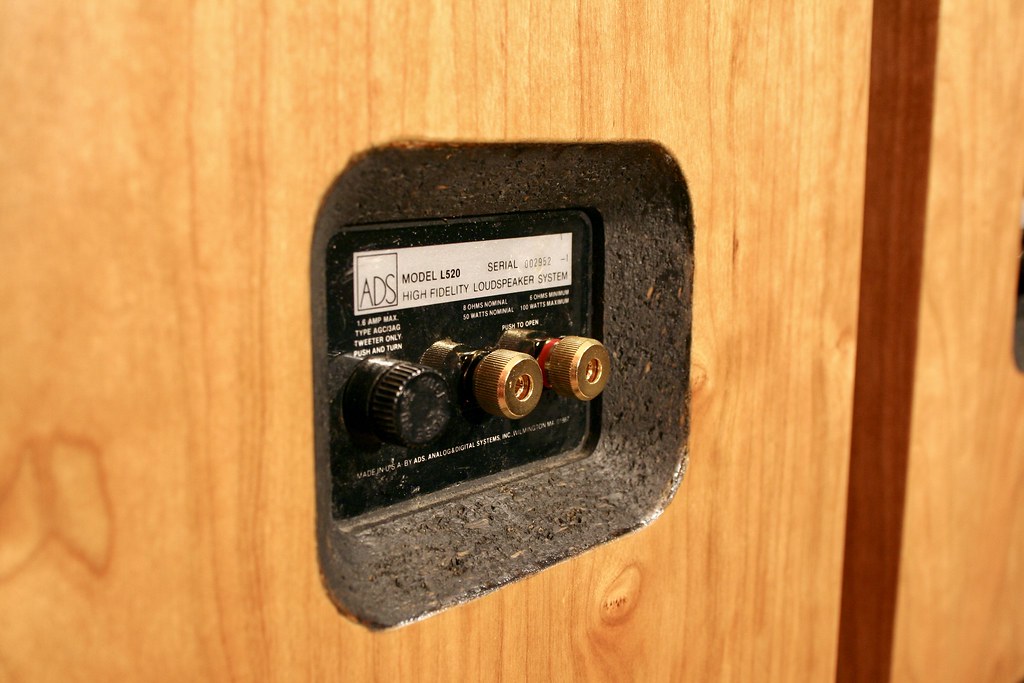

Where do you source your veneer and what kind? How much does something like this effort cost in veneer?
Wondering what you use to cut the veneer edges - and what is your sanding method? It appears that you sand your edges to a bevel, with no signs of edge cuts following the grain into the danger zone along the edge.
I get all my veneer directly from JSO Wood Products. They're great and also have an ebay store.
I only mess with paper backed veneer and contact cement. Raw veneer takes a great deal of extra work and equipment. That burl piece was an exception, and also a ton of extra effort.
These speakers are wrapped in cherry, a $60 (plus shipping) 4 x 8' sheet (very cheap for wood veneer) with plenty left over. Also, a bucket of contact cement is $30 but lasts several projects. Rollers, brushes, utility knife blades, 220 grit sandpaper, tung oil, rags and microfiber towels are consumables.
The biggest expense is simply time, these speakers were extra labor intensive because of the front edging.
I only use a fixed blade utility knife, the retractable ones have too much play. I flip / change the blade often to keep it fresh and prevent tearing of the wood. I cut close to the edge with the blade along the grain, then sand the rest of the way with a sanding block and 220 grit. When trimming an edge that is against the grain, I trim right against the edge with the blade. Against the grain is less nerve wrecking. Then follow with 220 grit.
I lightly round over the edges with the sanding block so it feels smooth and not sharp. The different kinds of wood veneer all vary in how much the edges show, just depends on how well the paper backer color matches the wood, the type of finish also makes a difference.

Finally got around to snapping some more pics of the ADS L520. I'm moving into a smaller place soon, so I actually need to get rid of most of my speakers. I'm not sure how many pairs I actually own right now, but it's over 10.
I'll be posting these on BT shortly.
The L520s sound absolutely amazing, probably the most accurate and clear vintage speakers I've ever heard. They don't have an excessive midrange dip, nor are the highs rolled off. Just accurate, full and clear with great bass.
I enjoy listening to these quite a bit.
^^^^^^ Forgot to mention: I did veneer the front baffles in cherry as well. However, I didn't like how it looked, it just didn't look like proper ADS anymore without black baffles, so I blacked out the fronts by mixing ebony stain with tung oil finish, yielding a semi-gloss black, compared to the more matte sheen the rest of the cabs have.

Question for you, how do you press the veneer when gluing onto the existing speaker cabinet? Most of the youtube tutorials I have been watching for veneer are of course doing panels only.
I press the veneer by hand, I make a fist and run the bottom of my palm over the surface systematically, sometimes I use a hard rubber roller, or if it's really small ledges I sometimes use a smooth, curved metal piece. They sell hand tools for pressing down veneer, but I haven't needed it yet. Those rubber rollers for sound deadener application can come in handy.
So no clamping somehow?
