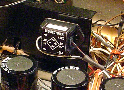

Found this lil beauty up on ePay a while back and have used it a couple times. Easy hookup (AC in/DC out, or vice versa) and good for something like 2-30v automatically.
One nice thing - I only converted about half the lamps on my QRX-9001, because the power meter lamps especially are a real PITA to replace. Those plug directly into the stock VAC with no worries, and if I ever get around to doing the LEDs there, just move the power tap to the other side of the rectifier.
