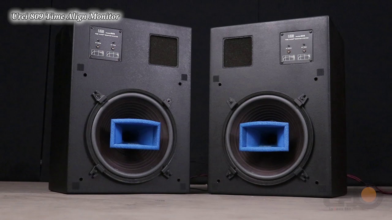

Love the heck out of my 809As (2 pair!) ... their time-aligned design was a revelation!
Added a JBL B460 sub (18") to the right side and it brought in all the bottom I need!
Even Tom Petty was a fan of the UREI Monitor sound!

I gotta say.. these Ureis left an impression on me.. And once again I see the whole time align thing... I wonder what a brochure or salesperson would have said
Wow, two pairs, AND that nice JBL sub. Nice!! I refoamed a pair for a friend who had them since the 90s I think.. Once repaired, I got to play around with them quite a lot.. and was thoroughly impressed! Only thing I was a bit disappointed in the bass.. from memory they didn't go down very low.. but, with a subwoofer, seems like you got the best of both worlds!
Also.. boy were those drivers heavy.. :rockon:

There may be/is some confusion in this thread.
I've stated only that speed of sound does not vary by frequency.
NOT that time aligning doesn't work. I believe this is being lost in the noise.
time aligning is correcting for phase, and lobing, among other things, and I think it's pretty well established that it has an affect on sound.

The idea with the above is by physically aligning the voice coils at the same plane, it creates a time aligned system, hence an impulse sound from all drivers arrives at the listener at the exact same time.
