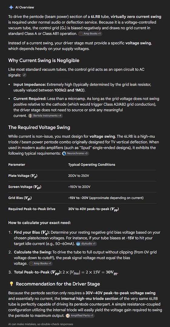

How much current swing is needed?
If I can get 80v I'll be extremely happy, I think I will actually need maybe 40, so the idea is plan for a comfortable amount of headroom so I don't have to be excessively concerned about it. I haven't hooked up the pentode section yet, and the sheets only give stuff at 120v on G2 so I don't exactly know where the grid voltage is going to land. Planning for 400v plate and 300v G2.
No, I'm wondering whether a 5mA swing will be enough? Or do you need closer to 10mA? That will determine which line on the graph to use (red or blue).

What tube or output device is it driving? Some need a larger current swing to reach their linear range. Others are not so fussy.
Just a thought.
Itself. 6LR8 triode section driving a second 6LR8 triode as a floating paraphase and a 6LR8 pentode. The other triode will just drive the second pentode.
The pentode is similar-ish to a 6CZ5 or 6973
Hmm... Mr Google AI... it needs voltage-swing, not current-swing fussy. :thumbsup:
