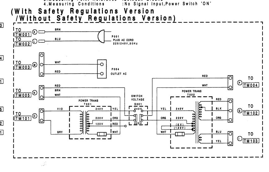

  • On the transformer, all of the pins closest to the rear of the machine appear to be connected to each other. Are they all ground terminals? These are the pins I'm talking about:
  • The reason for this pic was that the grey and purple wires seem to have no life on them. Measuring DC voltage was reading basically nothing - millivolts.

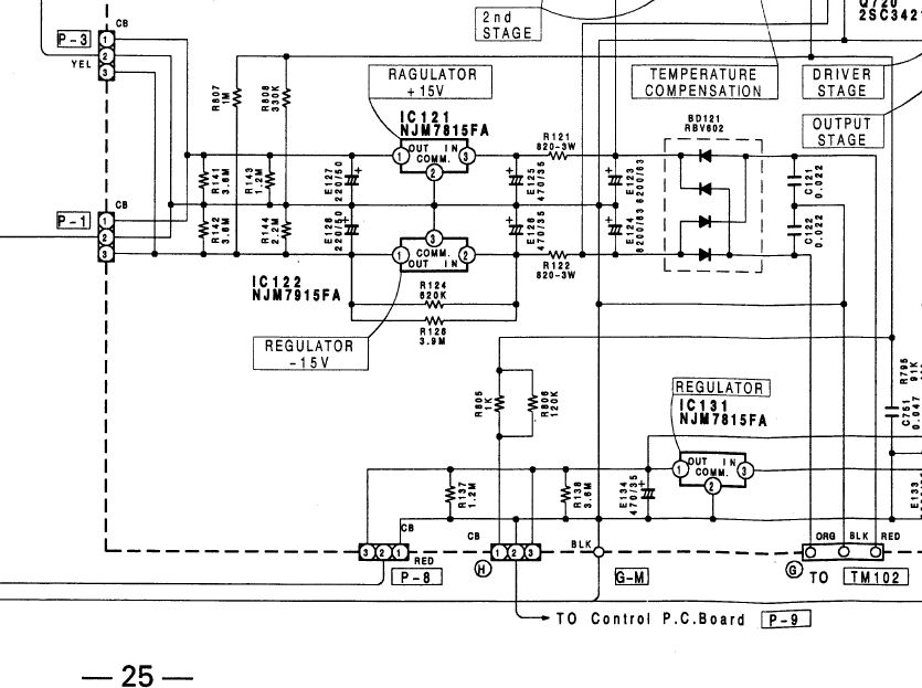

The fact that both power amps do not work indicates that most likely the problem lies in the part that both have in common and that's the power supply.

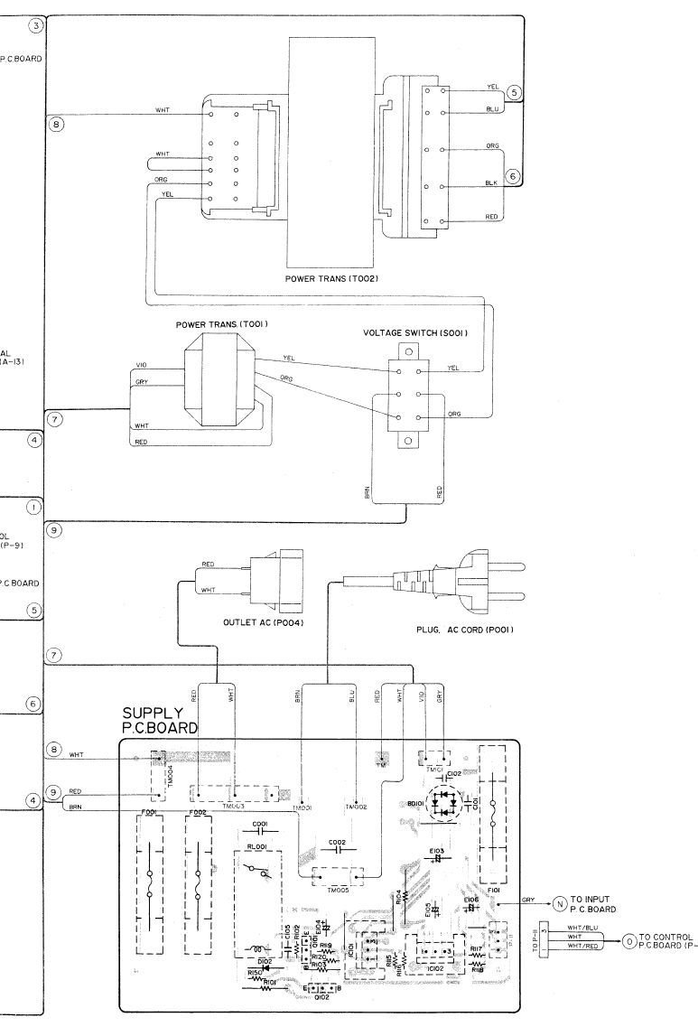

I can only find a schematic of an A371, maybe this detail gives you more insight in the power supply section, but be careful, this is of an A371!
Thanks guys - I ended up finding a schematic that is very close to the A-373 in the A-384. It has the same layout inside and even uses the exact same pairs of 2SA1492 x 2SC3856 transistors (it even has the same PCB silkscreen designations).
The major difference between the two models appears to be that the A-384 is some sort of hybrid design with a discrete tube PCB inside, but the A-373 does not have that.
www.hifiengine.info/luxman/a384serviceman.pdf
I need to study this manual I guess but if anyone wiser than me has some time to skim it and tell me some basic pointers on where / what to check that would naturally be very appreciated.
Hey all - I managed to track down the problem this afternoon thanks to aforementioned A-384 schematic (if anyone is working on this amp, that's the service manual you need).
What I noticed was that I was seeing ~18V AC on pins 1 and 3 (red and blue wires in the pic below) but after the resistors I was seeing nothing. The two fusible resistors (R601 / R602) were reading open. I replaced them and now the amp works perfectly. I ran it for 2 hours with no issues - hoping it was just a surge or some other shenanigans that took them out.
