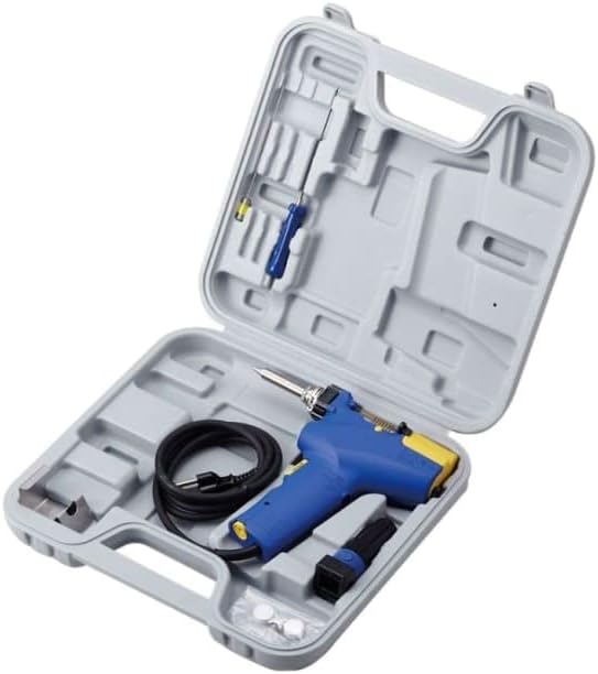

EDIT2: The Hakko FR-301 desoldering tool is the best thing imaginable for this kind of work, it makes removal of the components too easy, and this makes sure the traces on the PCB's aren't lifted or pulled up accidentally.
Can't recommend that enough.

I'd get that desoldering tool if I thought I was going to repair a few more amps, but I'm not sure yet. I currently have a small desoldering iron that uses a bulb to suck the solder off the board. Works ok, but not great.

The FR-301 can pay for itself if you find other projects for it. I build guitar amp clones, and use it for that too, makes cleanup or overhaul a joy. Buy old gear to fix and resell - mine paid for itself with a couple eBay overhaul-resales.
