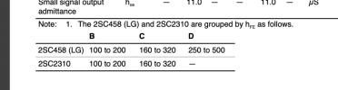

I was about to order parts for the phono board and tone board, but noticed the phono board has a transistor listed as "2SC 458LGA (B)". Looking at the phono recap kit from peace.love.and.music AKA Affinity for Artifacts uses a KSC1845FTA and says it's the "correct replacement". However, @MarantzRefrb uses the KSC1815FTA as a replacement for this and some transistors on the tone amp board.
What I don't get is -- what is a 2SC458LGA (B)? I only see this transistor listed as 2SC458LG with variations "B", "C", and "D". Is "2SC458LGA (B)" just the "B" version?
If so, it appears that the small signal hFE is 100-200, which his closer to the KSC1815FTA than the KSC1845FTA, if I'm reading things right.

I followed the hfe gain range as closely as I could with my transistor replacements, and according to the Service Manual.
Since, it's been reported elsewhere that the Phono board can oscillate if the 1845 was used, the recommendation was then to use the 1815.
Thanks! That settles it then.
But do you know if the "2SC 458LGA (B)" listed in the service manual is the same as "2SC458 (LG) B" in the data sheet?
