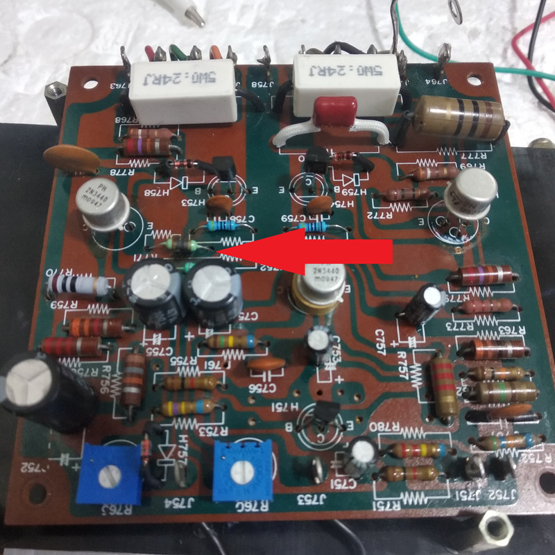

Hello AK'ers.
I´ve been working on a recap on my 2230. i finished the recap according the suggestions here, in AK.
main caps are new.... output transistors...... voltaje on P800 PS board are correct: 13.8v on j805 and 35.6v on j808.
P750 has new:
-electrolitic caps
part-------original-----sub
-h752-----c959-----2n3440
-h755-----c959-----2n3440
-h756-----a606-----2n5416
-h757---- bias thermistor+150R resistor------ 1N4148
-h753-----c371------ksc1845
-h754-----a562------ksa992
-h751-----c945------ksc1845
-h758&h759-----1n60----- 1n60p
also some new resitors with same value than original.
First time after recap i conected he receiver to DBT and got smoke on R771 (220R 1/2w) on both P750 power amp.
I changed h755 and R771, left chanel works fine, no resistors explodes.... DBT is ok when only this board is conected.
**************************BUT**********************************
POWER AMP RIGHT SIDE REFUSES TO BE REPAIRED.
al last 3 times h755 has been ruined and R771 still exploding....... as you can see many new parts are installed... even the 3300/63v coupling cap have been changed (twice), and the board has been recapted twice.... nothing can make r771 and h755 stop to go out of bussines. Some mj15024 output transistors has been lost on this board.
I tried to change the c762 cap (100pf) with 150 pF NP0 cap. didn't help.
** front side, many new pieces**
U7MeRZN
AT THIS POINT no idea how i could fix it.

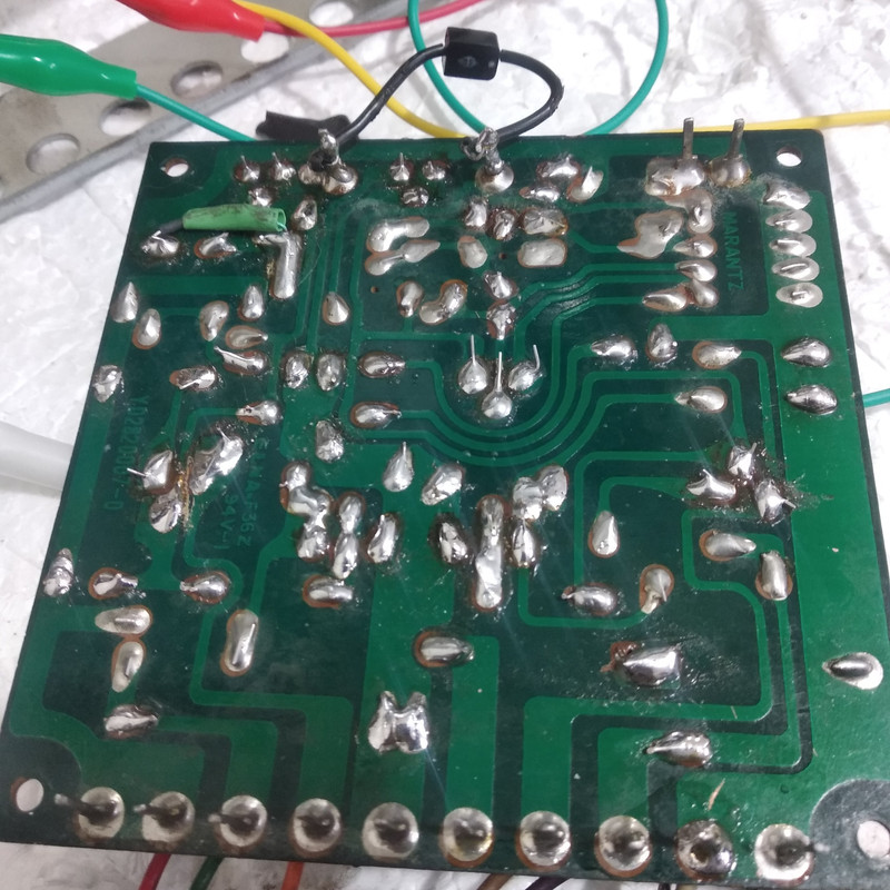

**the back side**
thank you for your help.
Ok, things that stand out to me:
The 2230 uses 2w emitter resistors. Not 5W.
1N60 and 1N60P are different.
The subs I have seen in the past are C371 to either KSC2383 or KSC945 and A562 to either KSA1013 or KSA733.

I agree. KSC945 looks like a better sub for C371. And I’m going to change the subs for A562 on my transistor sub list. A992 was found as a recommendation in more than one thread, but KSA733 is a much better match. On both of those transistors, the subs you used had a max collector current (Ic) that was half of the original. I don’t know if that could be your problem, but its worth trying the different subs.
Are both boards identical regarding the components? Is bias trimmer R765 at the same value on both boards when you are switching on the unit?

I agree, i also seen here the subs You say , but i also found here in AK the subs i installed are ok too. Honestly ksc1845/ksa992 are installed beacuse i have o good quantity of them.
Yes. Idéntical. Both R765 are the same, 1k 1 turn trimpot. Both was set to 450 ohm before installed. This value is the same that the one in the old trimpot before it was changed

I think your problem is not related to components rather in the trace of the board. I would take the schematic and follow all the connections on the back of the board and compare it with the good working other one.
You also NEED heatsinks on the 2 driver transistors 3440/5416. They're probably burning up along with an output transistor, hence the EMITTER resistor R771 smoking.
