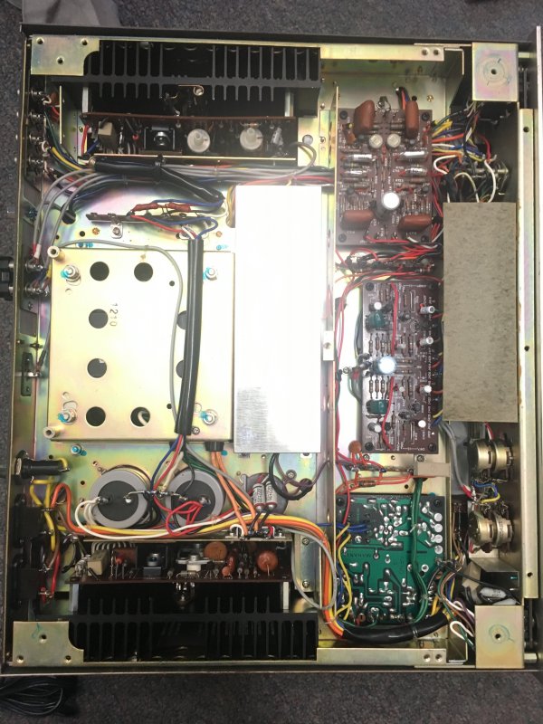

I have a 2245 that has a silver face and engraved with serial #1210.

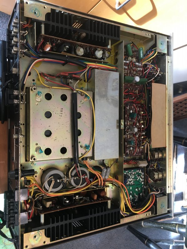

2245 sn1210:
2245 sn5511
...wondering if there is any extra value to these transition units?
Not in my opinion. It doesn't have some of the improvements that came later. But it's just as valuable as any other non-stamped face plate unit. Clean cosmetics make more of a difference and yours looks pretty good!
