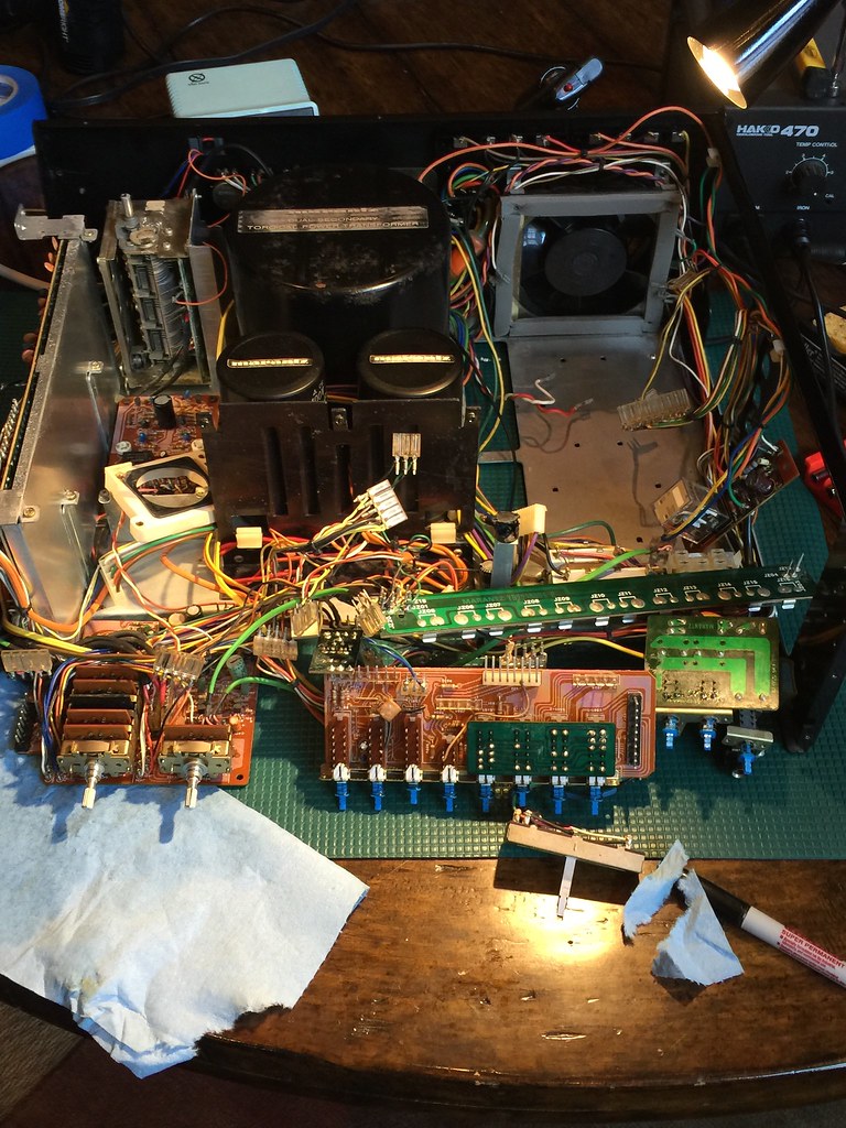

In the mean time I thought it would be a good time for some before, during and after pics...
As shown on ebay...
At home naked...
The fun begins...
Time for a bath... (really, it needed a disinfecting)
it's looking cleaner... But still has a long way to go till it makes music again.
Boards... hungry for new caps...
A sample of the 100+ caps...
It's getting better but still needs work.
Now it's getting serious.. The front frame needed to come off to really get access to all of the boards. At this point I am starting to wonder if it's ever going to go back together...
Getting close!
It's alive!
A few tweaks...
Back in one piece...

I still need to:
1. Fix the tuner sensitivity
I am really not looking forward to pulling the tuning cap... I still have not tried to inject the signal as you had suggested. I will try it in the next couple of days.
2.Re stuff the big caps
3.Repaint and resticker the transformer
4.Figure out a solution for the missing balance lettering...
My brother let me use his pair of Martin Logan SL3's to listen to it. It really sounds fantastic just hooked up to an iPhone.
