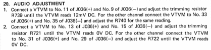

As far as I can tell, those should all be around 0VDC (or at least a few millivolts).
Since you measured a large voltage at each there is something wrong with your P700 boards or you need to adjust the DC offset.
Have you tried performing this?

After setting the power supply to 35V, I did not do the audio adjustment as the DC was so far off that I did not think I could get it down to normal with just the trimmer.

I'm not saying that you won't have problems setting the DC offset due to some other issue, but you should try it first to see if it will get close. You can measure some of the transformer voltages shown on the schematic and compare to the schematic.

I agree with @dankik trying to set the dc offset may at least tell you which side of the amp card is having issues. Edit: I now see you're seeing several volts on each of the jn01-04 you probably won't be able to dial that much dc out.
Yes, testing in 4 channel mode... unfortunately adjusting the trimpot only changed it a little.

So now can you set the DC offset for that channel?

Ran out of time last night so I will hopefully be able to get the offset/bias dialed in.
I was able to set the offset/bias for the front half of the right board... then discovered that the rear half of that particular board did not work. And somewhere along the way I have lost one of the 4 preamp channels (all 4 were working) I do have kits to do both amp boards. May have to set this one aside and back away slowly until I learn a bit more... but I have learned a ton on this one so far.
