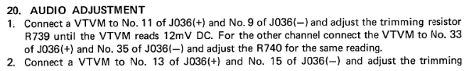

Have you tried doing this audio adjustment (again) after fixing your other problems?
Please measure and report the following voltages (don't adjust just yet):
  1. Connect your DMM (+) to #11 of J036(+) and (-) to #9 of J036(-) and measure the voltage.
  2. Connect your DMM (+) to #33 of J036(+) and (-) to #35 of J036(-) and measure voltage.
  3. Connect your DMM (+) to #13 of J036(+) and (-) to #15 of J036(-) and measure the voltage.
  4. Connect your DMM (+) to #31 of J036(+) and (-) to #29 of J036(-) and measure the voltage.
I haven't adjusted anything, but here are the readings I currently have. I did also notice that the grounds (the strap that connects to bottom of amp heat sink) wasnt soldered on, I will do that ASAP
  1. Connect your DMM (+) to #31 of J036(+) and (-) to #29 of J036(-) and measure the voltage. .001
  2. Connect your DMM (+) to #33 of J036(+) and (-) to #35 of J036(-) and measure voltage. .001
  3. Connect your DMM (+) to #13 of J036(+) and (-) to #15 of J036(-) and measure the voltage. -.83
  4. Connect your DMM (+) to #31 of J036(+) and (-) to #29 of J036(-) and measure the voltage. jumping around like it is AC being measured from .1 up to 1.2V
  1. Connect your DMM (+) to #31 of J036(+) and (-) to #29 of J036(-) and measure the voltage. .001 (should be 12mV DC)
  2. Connect your DMM (+) to #33 of J036(+) and (-) to #35 of J036(-) and measure voltage. .001 (should be 12mV DC)
  3. Connect your DMM (+) to #13 of J036(+) and (-) to #15 of J036(-) and measure the voltage. -.83 (should be 0VDC)
  4. Connect your DMM (+) to #31 of J036(+) and (-) to #29 of J036(-) and measure the voltage. jumping around like it is AC being measured from .1 up to 1.2V (should be 0vDC)
The first three look like you can probably adjust to the correct value as described in the instructions, but the 4th one we will have to investigate further to see what is going on.

Now my issue is the high DC on the offset for both front and rear. I will solidify the ground and check and reflow all the joints, they look like good decent soldering but who knows. I do have the kit to replace H707-H710 and H714 to H716 as well, and new trimmers on order.
Redid the ground and now solid... just in case I did replace the aforementioned transistors. Trimmers test fine on the multimeter.
Still having the problem... H701 not passing sound to emitter and H702 has -.83 at base... trying to make sense out of it, but unable to.
The base of H702 has -.83... it looks like from the schematic that the following the base from H702 continues all the way to pin 13 (which goes to the base of H003 output) and has -.83
The trimmer has no effect...
