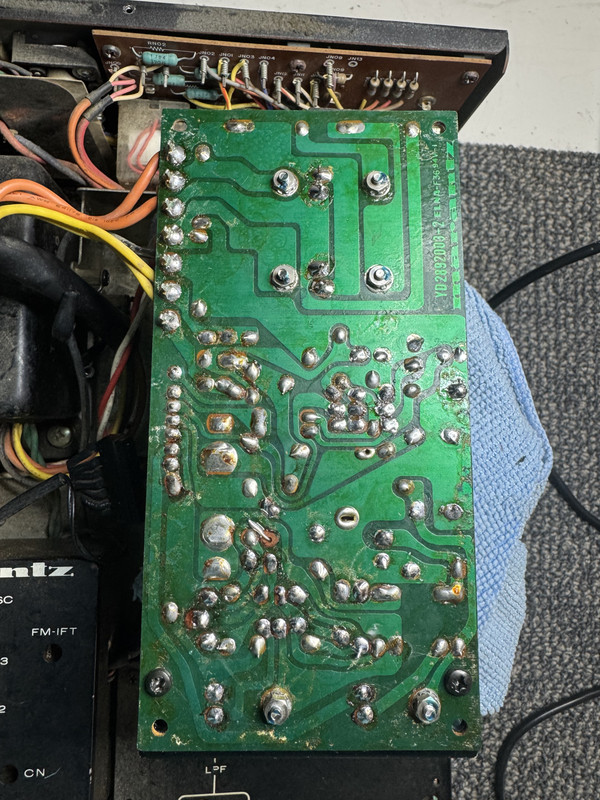

But the real problem is why H803b is 25V, again no current flow through R805 because of alternate low resistance path from H801e to GND. Going in circles a bit. Only if it's reasonably easy to do, post high res pix of the P800 board both component and solder side

Here is a link to high res pics of front and back of P800.

If it's that torn pad that looks like it's bridged I assure you it is not, just funny looking in picture.
Yeah, that's the one, it wouldn't give the symptoms you are seeing.
