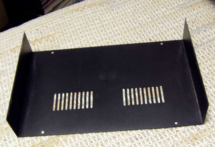

Installing a cathode follower buffer tube module
My initial hesitancy for "cut-outs in the top plate" were soon put aside so as to implement an additional modification:
The other available “plug and play” socket is the tube.
The sonic gains in upgrading the stock 6N3 tube with the GE 5760 is well worth the incremental costs.
Beyond “Tube rolling”, and inspired by the replacement of op amps with discrete circuits; I thus set out to replace the the GE 5760 tube with an entirely new tube circuit, installing a cathode follower buffer tube module.
I don’t know if the TubeMagic tube circuit is tuned for a slightly warm sound or if it's rather the limitation of a single stage tube output (likely both). However, in comparison, the cathode follower circuit is a proven two-stage tube buffer. It can indeed be, as advertised, “Frequency response is broadened, sounds accurate and analytic”.
Tube buffer stages are currently available at a relatively inexpensive price. My purchase from Amazon.com was as an “Assembled 6N3 Hifi Buffer Audio Tube Headphone Amplifier Pre-amp Kit with Transformer”.
Circuit installation is easily achieved: Remove the TubeMagic supplied internal tube, and tap into the signal inputs at pin-out 3 and 7. (I took care not to tap into the high voltage by mistake).
I am awaiting delivery of a 9 pin miniature socket saver that will make for a clean plug and play adapter; the signal leads will be soldered to the pins. Temporarily, for mechanical stability of the loose signal leads, I tied the leads' ground shields together to the socket retaining ring so as to keep the wires from being pulled out.
I then also switched in the now redundant GE 5670 NOS tube from the Maverick into the V1 position of the cathode follower, instead of the supplied Chinese 6N3. Another step up in improved sound. A second GE tube is on order to be switched into the V2 position.

YES, RCA to tube pin adapters or jumpers from 3 & 7 to the outs on the D2:
I used RCA cables as jumpers. I ran RCA cables (L&R) from the buffer pre-amp to the (empty) D2's tube socket. I cut the RCA connector off at that end, and striped off a short length of insulation. I tapped into the signal inputs at pin-out 3 and 7 by pushing the bare wire into the socket. ( take care not to tap into the high voltage by mistake.) I twisted the RCA cables ground shields together and then tied them to the socket retaining ring. This was so as to keep the wires from being pulled out, and also ties the ground circuit.
I subsequently ordered a 9 pin miniature socket saver so as to solder the RCA cable lead wire to the pins, but I have not got back to this project to upgrade the build hardware.​
Socket Saver.png​
The system sounds sweet. Of note: for my system, I need to turn down the buffer pre-amp gain knob, as with upgraded tubes, there is over-amplification,

Speaking of which ... Handiest mod I've done here is to slice off the wings on the top cover. Trying to slide it off was a real PITA.
Just drop it on ... don't even need to screw it in place as it still locks on tight.
