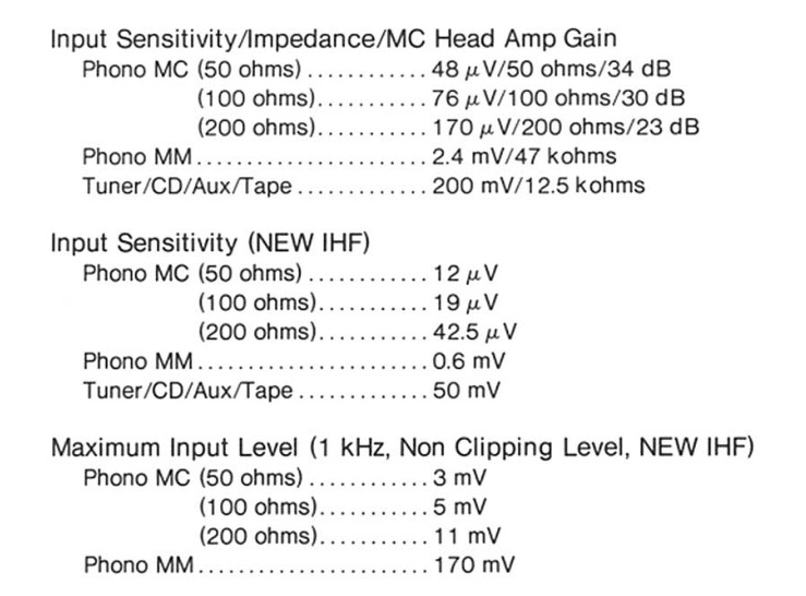

I am awaiting a Yamaha PX-3 this weekend, and I am thinking about trying out a new MC cartridge. I have heard great things about the Denon 103, but I am not sure if it will work with my pre-amp without a step-up transformer.
My pre-amp is a Nakamichi CA-5. It states the following in the manual:
Now, since the output of the Denon 103 is only 0.3mV, does that mean I cannot use it with the Nakamichi? What do I need to look for, what numbers do I need to match?
And then there are high output MC cartridges, like the Sumiko Blue Point 2, which states 2.5mV per channel. Would the Sumiko simply be connected to MM?
Any pointers would greatly be appreciated!
Use the MC input of the pre-amp for the Denon 103 and set the three way switch to 200 ohms. The sensitivity of 170uV (0.17mV) is the closest to the Denon's 0.3mV output.
Yes, the Sumiko would connect to the MM input.
They aren't separate inputs -- it's a single phono input with switches rather inconveniently located on the back of the unit.
Well with only one phono input, set the switches for the type of cartridge you are using. If you change cartridges, change switches as needed.
Sumiko BP2 MM position
Denon 103 MC position and use the 200Ω setting. you can also use the 100Ω setting and get a higher output into the phono stage, meaning the volume control will not be moved as high for the same volume.
Your preamp has 2.5mV MM input, 0.048mV MC input, 0.076mV MC input and 0.17mV MC input all switched on the back panel.
Cartridge output does not need to match the input level exactly. Let's take that 0.17mV input for example. You can run a cartridge with an output level of 0.17mV up to one that has an output of 1-2mV but not MM as this is an MC input. The idea is to match the gain needed to achieve output level of the preamp while matching the cartridge to the input characteristics (resistance and capacitance). This input does not overload until 11mV about 60 times the output level of the input sensitivity, so you will not be overdriving the input.
These resistance and capacitance numbers are on the preamp. The differences have an effect on the high frequency. You can try the 200Ω and 100Ω settings with the Denon and see if you hear that difference and whether you prefer one or the other.
