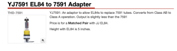

I was looking at what is available in the way of 7591s for my MC225 at Tube Depot today and they had this listing:
I'm not dissatisfied with the new manufacture Tung Sol 7591s I'm currently running, and I have a set of NOS with plenty of life left in them set aside, but I wasn't aware substituting EL84s for 7591s was possible. I'm further confused by the statement, "converts from Class AB to Class A operation".
Comments? Caveats?
Thanks in advance.

You can't. An EL84 will run out of oomph real quickly because of its plate dissipation of only 12 W. The 7591 is 19 W. EL34 comes a bit closer (different pinout). The AB->A could mean the adapter lowers the grid voltage from -16 to -7 V. See the datasheets for both tubes.

Even if it was a decent idea to sub an EL84 for a 7591, which it isn't because of wildly different operating parameters, it is worse to do so in a Mc225 because of the unique operating conditions of the McIntosh Unity Coupled output transformer. Read Mike Gibson's re-post of Dave Gillespie's explanation here: https://audiokarma.org/forums/index.php?threads/mcintosh-technology.336389/

I have a pair of Yellow Jackets intended to stick EL84s in place of 6L6s. Used them a little to try to tame the volume of my Fender Vibrolux. It was a very long time ago, I don't remember much about them. I don't think I disliked them, but I also know that I stopped using them. As I recall, it converted the amp from fixed bias to cathode biased. That's probably why they make the claim about class AB -> class A.
When I first posted this I didn't even think about guitar amplifiers but after doing some research and thanks to the replies here I've found out that Yellow Jackets are a device to do just what you say, allow the musician to tailor their sound to just the way they like it by means of tube substitution.
