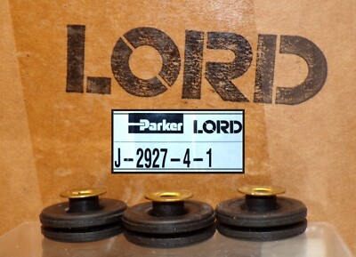

My motor grommets are still soft but not in great shape. How can I tell what ones to replace them with? The markings look kind of ambiguous.

Look like these.
