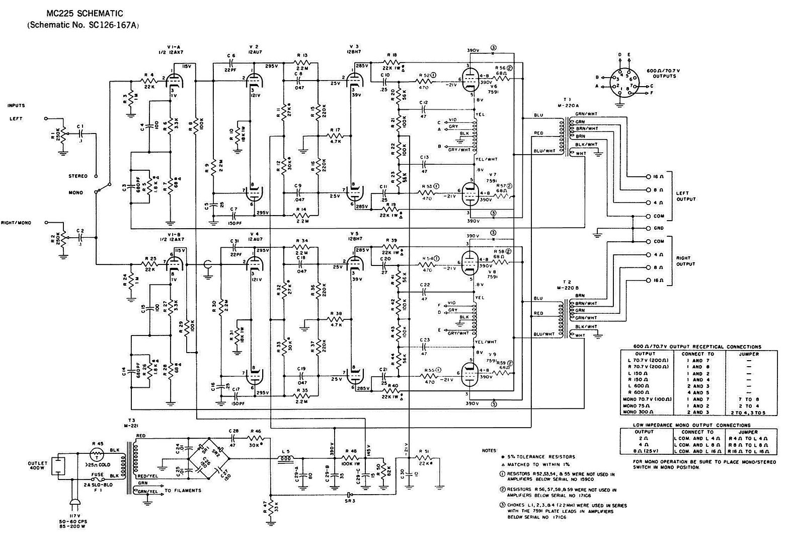

The bias line looks clean. I use a piece of wood to manipulate wires (out of habit with high voltage stuff). All soldering is stable. I did resolder related areas, though it made no difference.
My R&S UPV has a high gain when there is zero signal, so I turn on it's internal speaker and can hear hum down in the nanowatt range. Just by redressing the wires, I was able to reduce the hum to inaudibility.
If it's truly a 60Hz hum, it has to generate from a non-rectified part of the circuit. Power cords, power transformer, or heater lines.

The bias rectifier is half wave, so 60Hz would be the frequency.
True. But, you replaced the caps in the bias supply. Right?
Absolutely! I even added a poly cap across the electrolytic to suppress any RF oscillation that might be happening.
The only thing I hadn't tried was to probe it with a spectrum analyzer to see if something was oscillating in the VHF range, which might explain why grounded wires were acting like antennas.
This could be caused by some significant leakage in the power transformer to the chassis. Does the hum go away when the chassis is connected to a good AC line ground?

That was my thought early in the game. I measured under 1/2 mV from chassis to earth ground. Grounding chassis had no effect. Just moving the bias wire has ALL the difference!

I also find that older units with original wiring may develop EMF issues — maybe due to the wires becoming brittle. Sometimes, single-stranded copper wire cracks even though the insulation stays intact. And that can cause noise.

This wire is multistrand and in good condition-no breaks. It's just oddly sensitive to placement, almost like it's in a saturated VHF RF field.

Yes. Prolly the AC heater lines can generate the most EMF. And if they are near any low-voltage signal line, induction can occur.

Got a mystery problem here. MC225 amp, all new tubes, s/n A-weighted, left channel 80dB, right channel 72dB.
Audible 60hz buzz with nothing connected to the inputs and volumes at minimum.
Tried the filament circuit modification (ungrounding one side and putting 220Ω balanced resistors across both filament leads to ground. That just made the buzz equal in both channels.
Tried other tubes, same result.
Has all new filter caps. But tried added another cap across the first filter cap in the voltage doubler, but heard no change in level switching the cap in and out of the circuit.
Since this amp spent a lot of time in a garage, I thought maybe transformer leakage. So I checked the chassis to earth ground and did this with the plug reversed too, both times reading under 1/2 mV of AC from chassis to earth.
Oddly, the negative wire, from the anode of the rectifier diode that connects to chassis ground at the cap, acts like an antenna when I touch it and push it toward the chassis. The hum increases in amplitude! So I tried shorting this wire and re soldering it to the cap ground tab, but it still acts like an antenna! See red arrow.
Before I waste too much time chasing this one down, I figured I'd ask the community if they have any ideas as to the cause of this hum.
