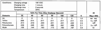

Perhaps because the dielectric absorption of PIO is so bad. Ditto for the Bumblebees, which I believe are mylar.
I would like to see what the original coupling caps sound like
If you replace them with polypropylene, they won't sound like anything. :)
Here are two charts showing properties of common capacitors. PIO isn't on the lists (most companies no longer make them), but several white papers online indicate they are worse even than electrolytic in this regard. The most practical coupling cap dielectric now in terms of cost, size and availability is polypropylene. All the needed values are available at companies like Digikey and Mouser. There simply isn't a good reason to spend more for hi-fi.
