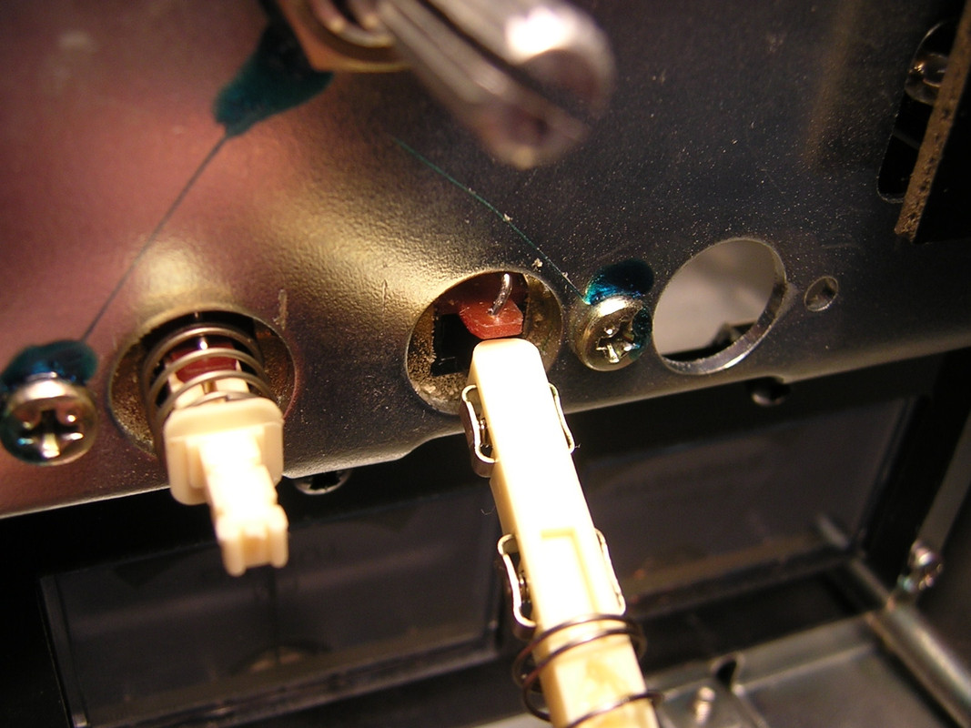

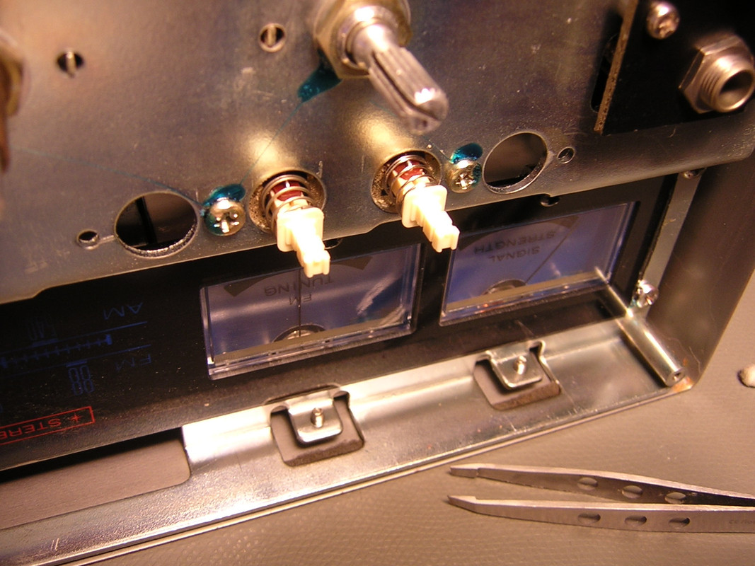

First remove the front of course and put the receiver upside down. Here it is a 2245.
VERY IMPORTANT: the switch has to be in the OFF-position:

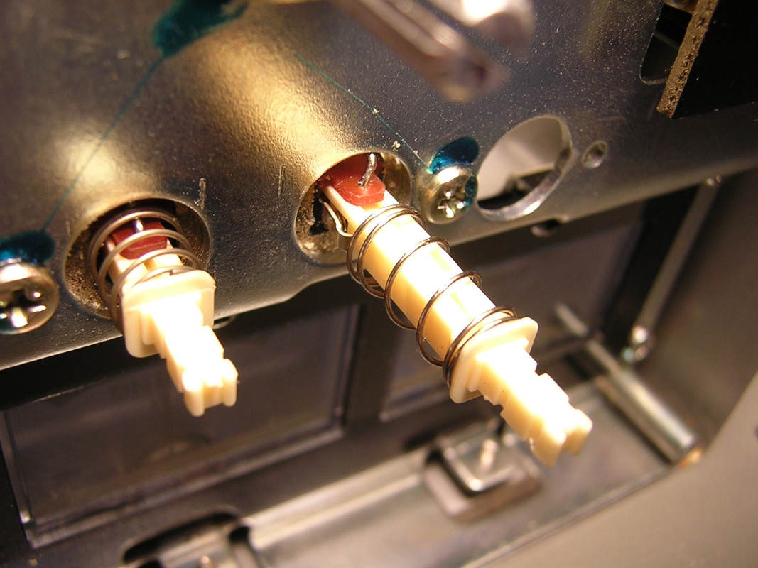

Pull the little spring towards yourself and hold it in that position until you have access to the little metall piece you see on the top.
Now, lift up that piece carefully and pull the switch out. It's a good idea to have a look inside too, to see how it works. If you know, and with a little bit of practice, it's possible to do it from outside only...
Take care of the little springs inside. There is a spring behind every contact on the stick. They easily get lost and tend to fly through the whole working room!

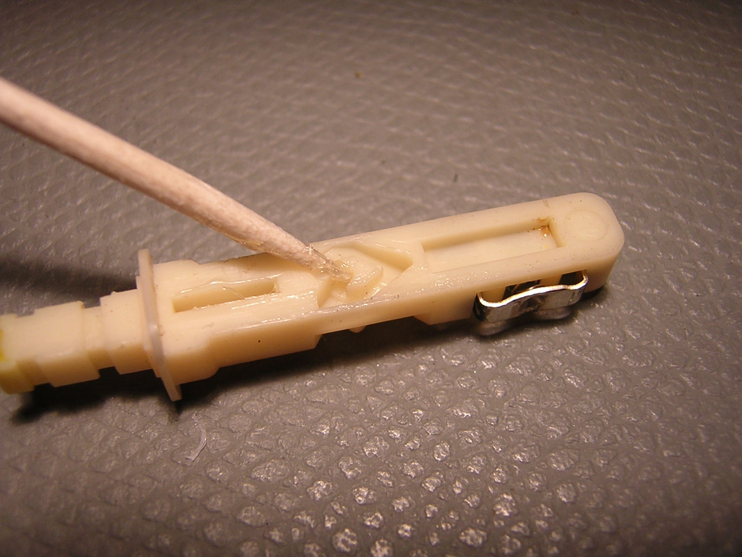

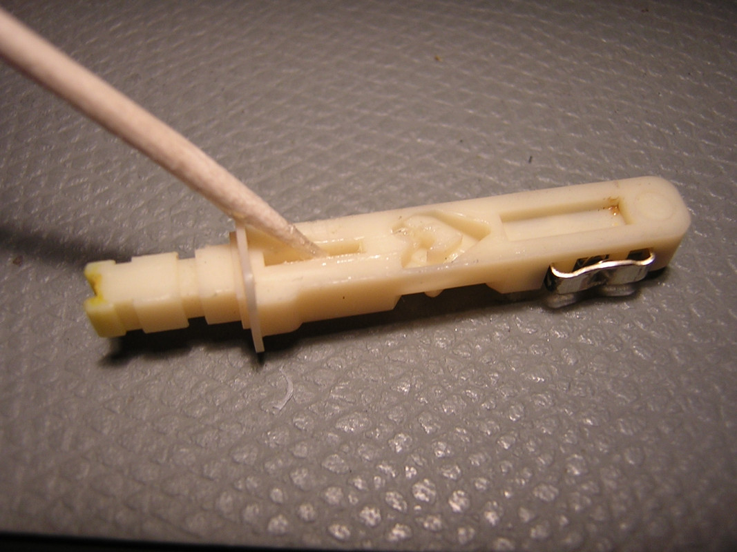

Here I added a photo, of what you can expect:
Now you have acess to the contacts for cleaning. Don't forget to clean the contacts inside the unit, too. These are usually worse, than the one on the stick. Use a cotton swab, or whatever you like. :thmbsp:
Reassemble vice versa:
Done!
If you want, you can put a little bit of grease on the moving elements. (Where the metall piece is)

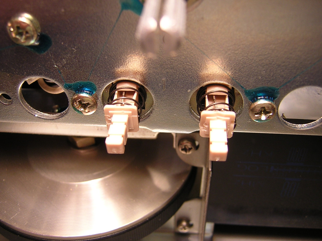

Here another switch:
Some switches have a different mechanism, they look like this. I havent figured out yet, how to open them. And there might be others, I dont know. :sigh:
