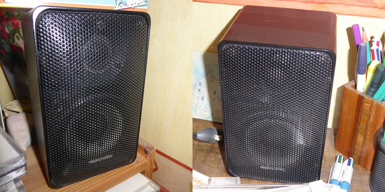

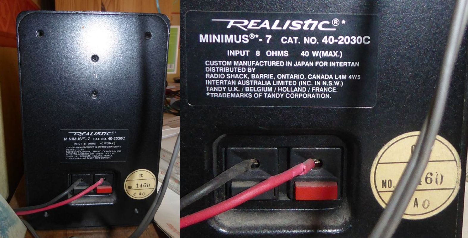

Oh, we have a pair of Realistic Minimus-7 at home :
I remember that these tiny-cool speakers were very decent sounding for their size ! :cool:
I should A/B them with my other miniatures , just for a comparison :
