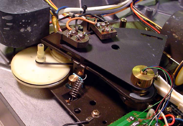

I've been told that, while the platter is direct drive, the arm mechanism is belt. I've looks at the service manual for this table, and I'm not seeing a belt. This table has been boxed and in storage for a number of years. Due to medical issues I'd lost interest in the hobby. I'm gradually making a comeback, hopefully... Anyway, the arm no longer moves. That's why it had been placed into storage in the first place.. Any idea why this would be happening..?

If you lift the headshell can you hear the queueing motor running? If so, its the belt in the tonearm which needs to be cleaned and replaced (as the old belts break down to goo)

Any progress report? As mentioned, the table is well worth saving. If it's anything like my DP-EC10, there's three belts, two for the arm drive's timing pulleys, and one for the drive motor. All four need to be square profile to fit the pulley groves.
These have already been replaced. The old ones had turned to goo and were a PITA to clean out of the white pulleys' tracks, but you do want to get them as best as possible. The drive motor mentioned is the vertical black blob top right in this pic. You can also see the wheat grain bulbs mentioned top center. Two of mine were burned, but I replaced all four while I was in there. Standard stock at radio shack, but not sure where you'd find them now.

Yup, the motor I was talking about is strictly for the arm drive mechanism. Here's a better view of my table that I imagine is a fairly similar setup ...

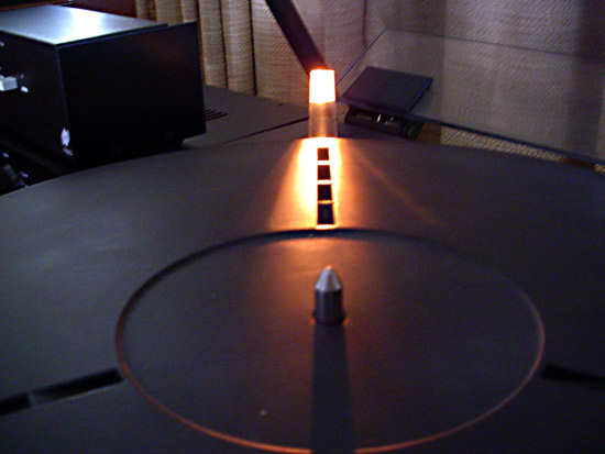

The bulbs shine through slots in the matte black masking disk to time the drive's movements. There's photo sensors on the other side of the disk that actuate the motors when exposed to the light. Pretty trick for the day, eh.

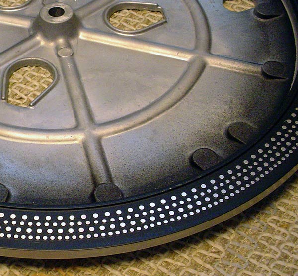

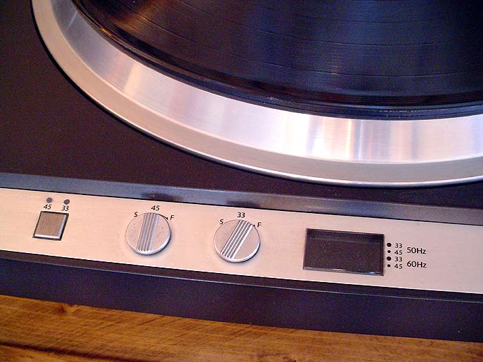

Mitsu had an interesting setup for speed control - the gauge was cast into the bottom of the platter and was read by sensors.
That casting was reflected into a window in the control panel to give a visual indication of speed.
The table also read arm set down position for different size disks using a prism tower that beamed a light across the top of the platter and reflected back from prisms set into the platter surface.
