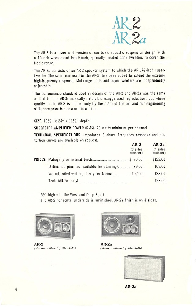

Edit: OTOH, just read this on the back of my AR2a's:
1. Connect 8-ohm output tap of amplifier to speaker input terminals 1 and 2.
And this ad for the Heathkit version of the AR2a, which is spec'd at 8 ohms. Interestingly, the freq response is spec'd to be +/- 5db from 40 - 20,000 cps. Dispersion is 90 degrees horizontal, which is how I have them positioned right now, at ear level, and they are sounding pretty damn good... Xover at 2,000 & 7,500 cps...
http://www.classicspeakerpages.net/IP.Board/index.php?act=attach&type=post&id=3390
Here's the AR spec sheet, again 8 ohms: http://www.classicspeakerpages.net/_Media/ar-3_and_turntable_page_4-4.jpeg
