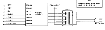

I recently won a Denon DRM-550 at auction. I have had one of these in my “not for sale” collection for fifteen years and it’s been mostly great. Now I have two, but there’s a problem with the second one. Mechanically, it's is tip-top. FF and RW are solid. The meters all work as they should. I can even record, but I have to use another deck to verify the recording because this Denon is silent in PLAY mode. Everything turns and the tape is in place, but there’s no signal and no meters.
The image is from the schematic. I’m able to verify the voltages given here with one exception: TR904 isn’t accessible until I pull the PCB out, which I’d rather avoid. I have fixed over a dozen decks since I started doing this, but mostly mechanical issues. I need a little help from my friends. I have the rare option of comparing this unit to my working one, but I don’t know how to proceed. Ideas? I do have the service manual and a multimeter of course.

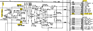

One thing to note is that the Line Mute switch does not appear in the circuit (as least the simplified circuit). Maybe it is always muting the audio on Playback?
Here is the circuit for the Line Mute signal.
See if you can find header CB121, Pin 12 and check to see if Line Mute is high or low, or if it changes when you hit PLAY.
Line Mute is an inverted signal, so probably = Low when muted, High when unmuted.

What is "line mute"? Is its purpose to block the signal from the play head anytime I'm not in playback mode?
I think if TR104 or TR204 failed, I would still have a signal on one side, no?

There is a signal "LINE MUTE" that gates the audio signal ON/OFF going to the output. The signal is gated by FETs TR104 & TR204.
The mute gating signal is on the TR304 collector. It should be:
  • STOP = -16v
  • PLAY/REC = +7v
The LINE MUTE signal looks like it is generated in IC501 pin 26.
The audio signal from the PLAY HEAD follows the green dotted line path to the output jacks. So, if the PLAY signal from the tape head is not getting to the output jacks, the problem has to be a component in this green line path. And, since you have the problem in both channels, it is something that is common to both L & R channels.

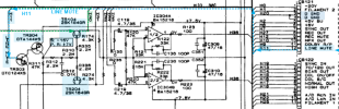

  • STOP = -16v
  • PLAY/REC = +7v
Sorry, one more path to check R/P (see purple arrow). Measure voltage in record and play. thanks.
At the purple arrow, I get about what I should: REC -.35v / PLAY -7.4
Likewise at the collector of TR304: STOP -15.6v / PLAY-RECORD 7.3v

Is there a chance that TR104 and TR204 got damaged by the same incident, and thus don't gate the mute signal as they should?
I don't know. If you had a scope you could look for the audio signal at the FET source and drain to see if it's getting through.
