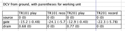

All looks to be OK. Can you measure DC voltage at FET TR101 and TR102 D/S/G in Play & Rec? If the FET is bad, either the gate voltage is not getting there or FET may be bad?

What puzzles me is where does the incorrect TR101/TR102 gate voltage of -24v and -15v come from?
Here's what I think is preventing your Play audio from going through.
  • Look at the FET TR101 gate voltage, red voltages are the for bad deck, green are for the good deck
  • For the good deck, REC is -5.7v and PLAY is -0.48v, but for the bad deck REC is -24.1v and PLAY is -15.2v (both in the cutoff region)
  • In the good case, when in PLAY the Vg is -0.48v (which should turn on the FET and allow signal to pass through)
  • But, in the bad case, when in PLAY, Vg is -15.2v (which is deep into the cutoff region of the FET) causing the FET to turn-off and prevent signal from going through
  • See the simplified JFET description below
  • Now we need to figure out why the voltages at the gate terminal of TR101/TR201 are bad in both REC and PLAY...

On to the critical TR101 & TR201 gate voltages, where the real anomalies are, and probably consistent with what I measured on the op-amps at the start of this whole thread.
PLAY voltages at the gate were -13v to -15v on the bad deck, 0v on the good one.
RECORD voltages at the gate were -22v to -24v (bad) and -5.81/-5.81 (good).
Where are these large voltages coming from??? Unless... there is something else connect to the FET gate that is not shown on the schematic???
The voltage on the other side of R102 (as you measured) are R: -7.3v/P: 5.7v
Maybe check the FET drain & source voltages also.
Can you check the PCB and see if there is anything else connected to the FET gates?

At the gate of TR101: Play -14.8v / Rec -24.6
At the gate of TR201: Play -13v / Rec -23v

My observations:
  • The voltages prior to the FET gate at the cathode of the diodes look OK, about -6v for REC and +5v for PLAY
  • But, since the diode anode voltage is always less than the cathode, no the diode will never conduct, so the diode may be OK
  • For whatever reason (either real or meter error), the FET gate voltages are way off. Also, both FETs have nearly identical bad gate voltages?
  • I would replace the two FETs and see if that fixes the gate voltages
  • TR101/TR201 2SK373(Y) -- unfortunately IDK a substitute for that FET? If you look for a substitute, make sure the drain current spec is the same as "Y"
