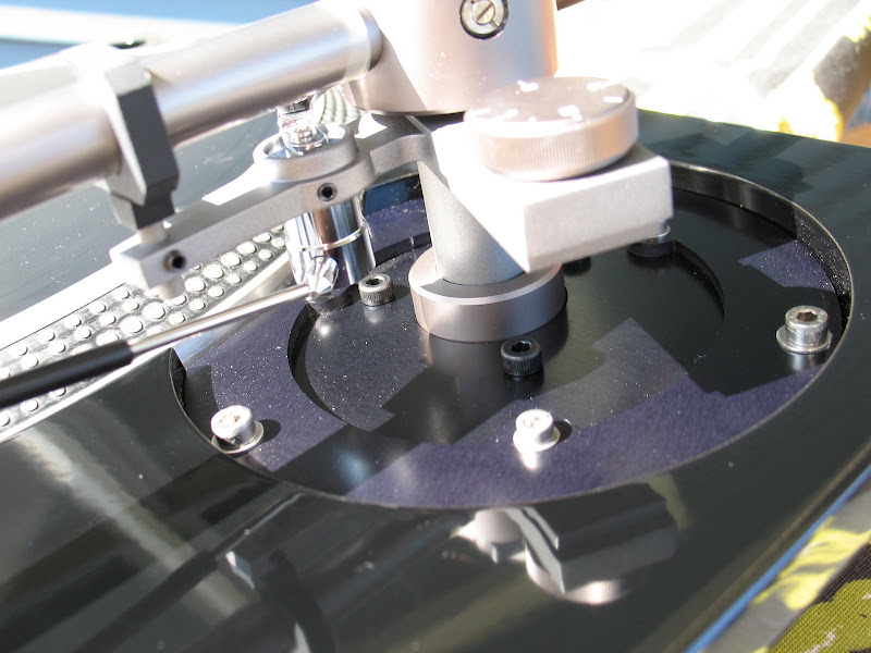

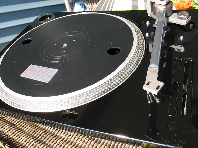

As of today I got the PT-9, arm board from Greece, and the powder coating is done. Unfortunately, the powder coating is not perfect. They said there was "out gassing" where the sticker was in the lower right corner. I don't really understand how/what happened, but it is what it is. I guess I can either live with it, sand it down and get it done over again, or find another one/use the stock one and have that one done with hopefully better results. Since I'm still waiting for some KAB parts I have a little time to figure out what to do about it. I'm leaning towards either leaving it and just finding a cool/appropriate sticker to cover that up or waiting until I'm ready to take apart the stock one and swapping them once it is done.
Anyway, I couldn't resist putting the arm board in, setting the tonearm on, and setting the platter in place to see kind of what it looks like and snap some pics for an update.
I'm not quite sure how the PT-9 gets mounted, I don't think I have it on there right yet.
