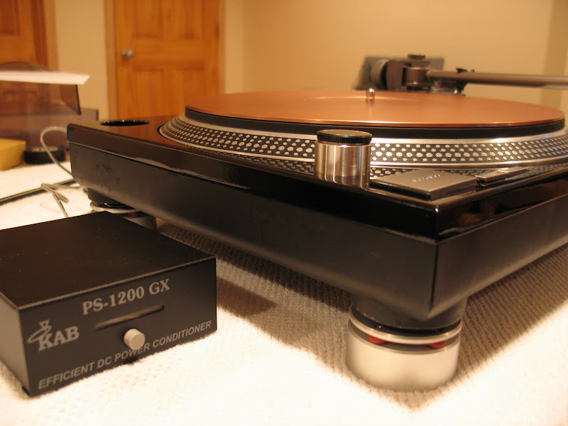

I will take some better "money shots" when I get the rest of my parts delivered and installed. I got a dust cover today and finally got notice that the copper mat shipped as well as the external PSU.
I must confess that I have started listening to it already, I couldn't stand waiting anymore. I got it spinning this weekend. I still need to get the cart/arm set up better, but I can say it's already significantly improved over the stock unit. As it should be of course.
Once I get these last details worked out and get things set up properly I'll be doing a little shoot-out comparison with the stock deck and some better pictures of the final product. As well as a complete run down of what was done.

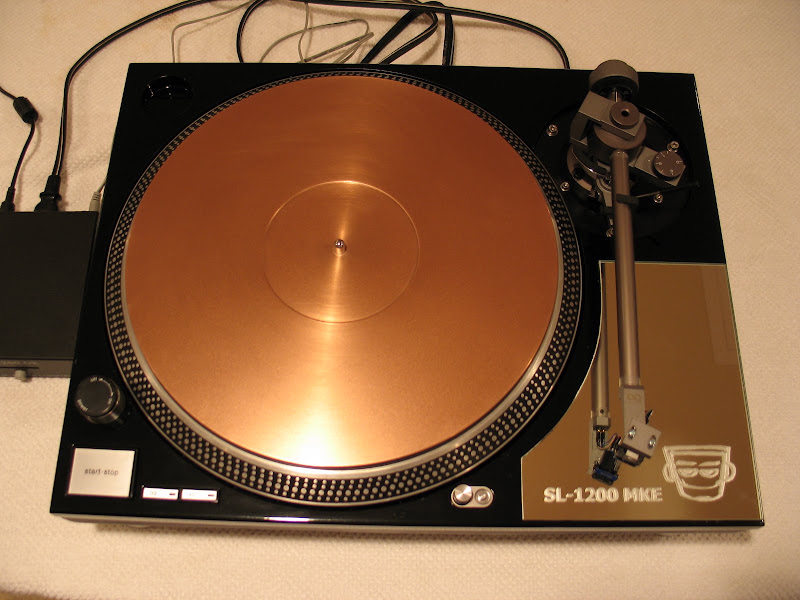

List of upgrades/mods:
  • Audioquest PT-9 Tonearm
  • Armboard from seller in Greece
  • Improved Bearing by Applied Fidelity
  • KAB USA External Power Supply & Strobe Disable
  • TT Weights Copper Mat
  • KAB Super Mat
  • Isonoe Feet
  • Removed & Bypassed Pitch Slider
  • Custom Mirror to cover Pitch Slider hole
  • Gloss Black Powder Coating
  • Also, custom MintLP Best Protractor
I spent a little time tonight setting up the arm (after I took the pictures). I'm still going to have to spend some more time on that though. It's pretty darn close for right now.

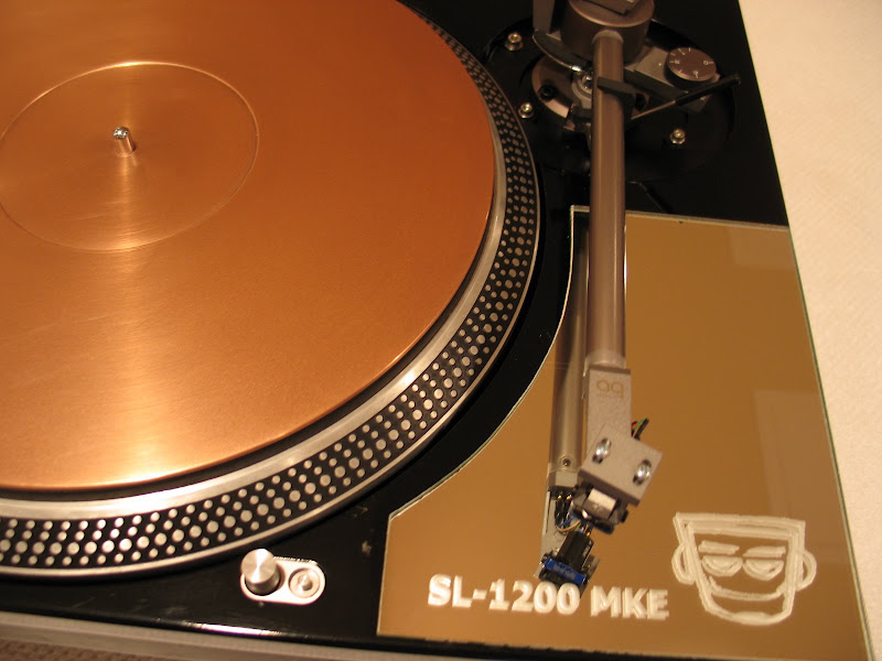

gorgeous!!!
i love whats been done with the mirror.

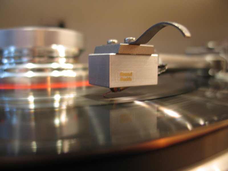

Could you give some more info on the cart? It looks like the body has been swapped out, and is that a Sound Smith ruby cantilever I spy?
thank you
and yes! Aluminum body off the auction site from a seller in UK.
Of course I snapped the cantilever off the practically new 103r right at the end of installing it :( So I sent it off to sound smith for the ruby/contact line re-tip, 8 weeks and $250 later...delivered today....installed about 2 hours ago.
I was SCARED TO DEATH while installing it.
