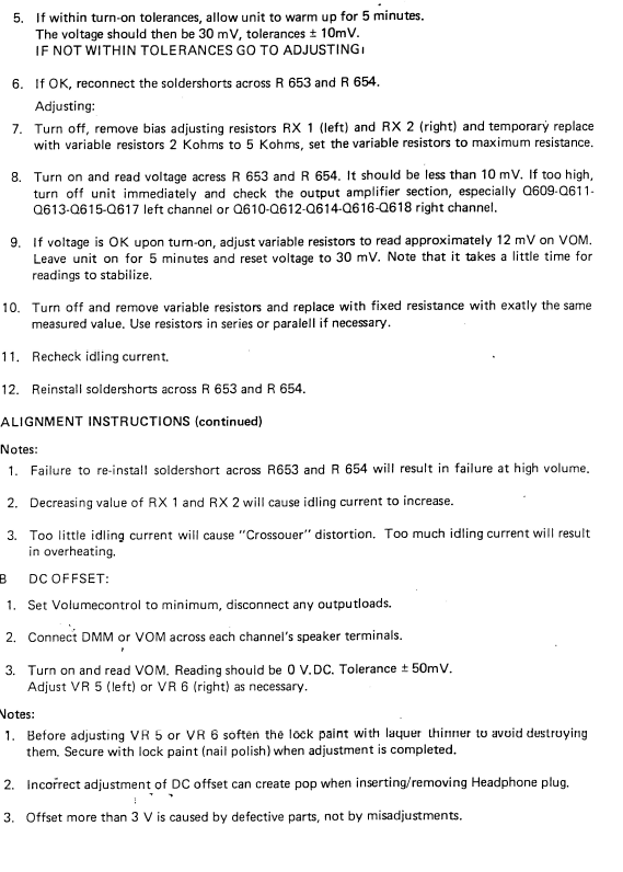

Something that should be clarified about these NAD 3020 amps is how to adjust the bias and offset. Early amps can be identified as those which have the four main smoothing caps behind the headphone jack, later ones have these in the center of the board, and even later ones have just two larger caps.
For the early versions, it says to measure across resistors R653 and R654, but these are not fitted on the board, at least not on the ones I've ever worked on. These resistors are also not shown on the schematic, not very helpful either, they are in the component listing however (confusingly as R653 and R656), listed at 0.22 ohms. Fitting these resistors is straightforward, but you'll need to cut the track underneath them as they are shorted out. If you have fitted trimmers (recommended), you can then adjust the bias to between 5 and 11mV. I adjust for 11mV, just so I can say "these amps go to 11".
For the later versions, a 1 ohm resistor is already fitted in each channel (R653 and R654 again), and there should be a solder bridge across it. Simple unsolder this, and measure across it. Again, if you have taken the step to fit trimmers, it is easy to adjust the bias current to within 30 to 60mV. Some versions of the service manual suggest somewhere in this range, others like for the 3120/3020B say to adjust it for 30mV. I try and stick to 30mV or slightly higher.
Just make sure you are using the correct resistor and set the bias for that resistor. There's no reason why you can't use a 1 ohm resistor in an early amp, set the bias to 30mV, and then bridge the resistor with solder or a wire like - VERY IMPORTANT! Rather than try and probe the boards, I always solder a couple of scraps of wire onto the pads for these resistors, and bring them out under the front panel. Just be careful not to let them touch anything, I tape them to the bottom of the panel to stop them flapping in the breeze.
As for the offset, I'm still considering this. All the 3020s I've worked on, the factory offset trimmer is always adjusted right over almost to one side. On a 20k trimmer, I'm measured resistances of as low as 4 ohms, which doesn't seem like a good use of a 20k trimmer. Even with the Bournes multi-turn trimmers, I've found I've always had to adjust them right at one end. I'm experimenting with some different values for the trimmer and the resistors around it - watch this space!

A tip for 3020A owners on setting bias if you have modified your amp as suggested by Lee.
I was having trouble getting any bias voltage measurement across the 1 ohm resistor (I thought I must have made a mistake during recapping and modification). Eventually after many turns on the multi-turn trim pot the voltage started to come up. Same issue on other channel, and I turned too fast and voltage went from zero to infinity (well, very high) too quickly and I shut off before damage could occur. I went back and measured the combined resistance across the trimmer and had a value of ~125 ohms. I set the other channel to that resistance value, turned on, and the bias voltage was now in the right ballpark.
Hopefully this tip might help others when setting the bias. The use of multi-turn pots certainly makes setting bias and DC offset much easier than old fashioned trim-pots.
(And yes, this restored amp is working beautifully. Those electro caps were well past their use-by date. This amp had a terrible turn-on buzz/thump/hum which has all gone. Just the regular low level thump at power on as would be expected. I suspect the main filter caps had worn out. I replaced with 4 x 3300uF - same physical size, greater capacity.)
On later amps, the bias adjustment resistors (R645/646) are 180R, with a value set by the factory in parallel with them (RX1 and RX2). "Later" amps are the ones without the power supply board on the back, and the four caps in the center of the board. This also extends to A and B models, plus the 3120. I always swap out R645/646 with a 1K2 resistor, that makes the adjustment easier.
Lee.
