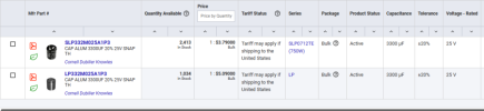

What lead spacing do you need? Looks like about 10mm lead spacing.
C405 3300uF/25V​
C404 2200uF/50V​
Digikey has these in stock 10mm lead spacing.
C405 3300uF/25V has ~10mm lead spacing
C404 2200uF/50V has ~12mm lead spacing
The ones you show are "snap in" without long leads. I saw those yesterday on DigiKey but didn't think snap in leads would work. Will snap in leads work?
The snap in leads, if possible to use, are so short they would need to be exact. Don't think those will fit exactly...

Note there's also extra holes for both caps. Thus there are both 10mm and 12mm holes.
So will the 10mm snap-in's work?

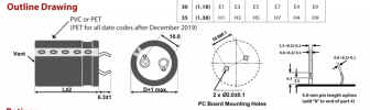

I think they should work OK. Here are the dimensions. (see drawing) Please double check.
  • 10mm lead spacing
  • 6.3mm lead length
  • PCB mounting holes 10mm with 2.0mm mounting holes
