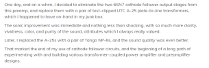

All, I am considering a Bruce Berman derive Type 76/6SN7 preamp. However, in doing my homework, Mark Walker (Blueglow Electronics) recommended an article from "Positive Feedback" where Bruce Berman provided an article chronicling much of his history. In the article Bruce mentioned improvements made in his Type 76/6SN7 preamp which involved the use of a plate-to-line transformer. If I understand correctly, Bruce completely eliminated the 6SN7 CF stage. However, he may have kept the 6SN7 but used the plate-to-line transformer instead of the CF output. If anyone has insight or (even better) a copy of the final schematics, it would be much appreciated. An excerpt from the article follows.

I also plan the JE Labs 6V6 with Hashimoto HL20K6 based on JE's recommendation. The reason I want to do a Type 76 with Hashimoto, is I have already built the base preamp with a Type 76 tube. However, my version not CF.

Thanks for your thoughts. I am currently in boxes waiting for our house to be built. I will tweak the Type 76 when I get a chance. Probably stick with single stage 76 based on Bruce Berman's later version. He eliminated the 6SN7 CF stage and added the Tangos. He has since gotten rid of the 76 linestage altogether in favor of a TVC volume control. each system is different. Regarding my slight hum, I have an idea. Steve Deckert had a recent video where he discussed gain control. He puts a volume pot on his amps. That way the gain can be reduced at the amp. SInce my KT150 monoblocks do not have gain control, they are amplifying everything from the preamp full-on (including any noise from the preamp power supply). By attenuating the gain at the amp, I can now control the gain at the input of the Type 76 linestage and the PS ripple would not be fully amplified at the power amp. I've already added the stepped attenuators to my monos, but have yet to test my theory.
