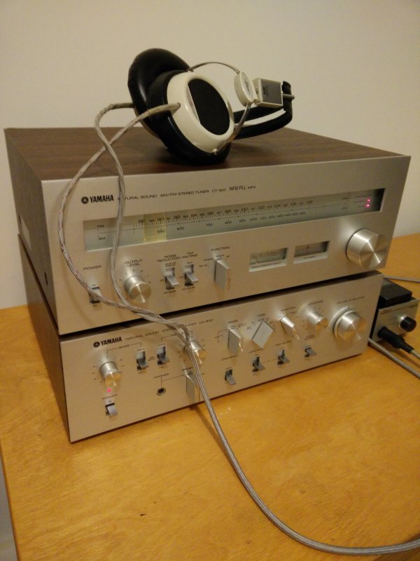

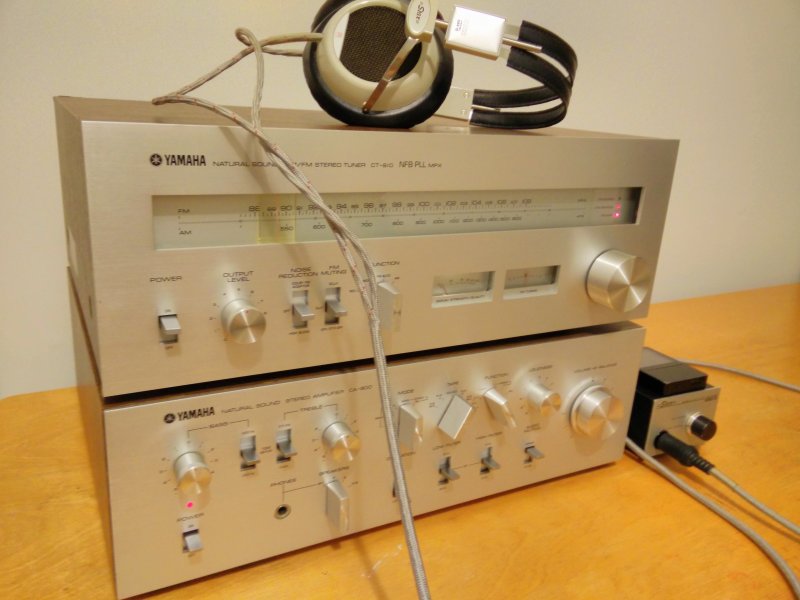

After pouring rain and two hours on the road; after getting the kids fed, teeth brushed; the dog walked and fed; I finally get to clean and hook up the tuner. And when I finally envelop my ears around my Stax for the moment of truth--HUM!!!
After all that, I still get the hum! Scratch that, I only get the hum when I use the tuner, aux, and phono inputs. But when I use the tape input, no hum. Only the opposite, great FM lushness, and yes, glowing lights and TWO dancing needles (when I hunt stations anyway).
So hit the owners' manual and I've come to a theory on the hum: ground wire. I think I need to hook a wire from the amp to a ground:
http://sportsbil.com/yamaha/ca-800ii-om.pdf (page 22)
The manual diagrams a ground wire from a turntable, but on my P-20, it only has the RCA plugs and a mysterious 3.5mm plug, can this be the ground? If so, I'm going to need to strip the plug. Or, I'm thinking I can use one of many commercial grounding applications:
http://www.lessemf.com/ground.html
Anyways, thought to update. Back to the rye and music, and surfing the internet for the CT-800 (!) and speakers (gotta grow up and ditch the headphones).
Some pics:
The way I fixed the hum/plug on the P-20 I sent my parents was to cut the plug off at the plug and solder on a spade connector.
That is a coaxial wire, and if I recall correctly it is indeed the outer you need for the ground, but, I did this process exactly one time back in October. I'm 99% positive it's the outer of the coax you need, but for the hell of it, and in a measure twice, cut once mentality, before you clip off the inner core wire, test with the bare outer wire to see if it remedies the hum. If it doesn't, strip off a little tiny tip of the inner core and try it to the ground terminal.
