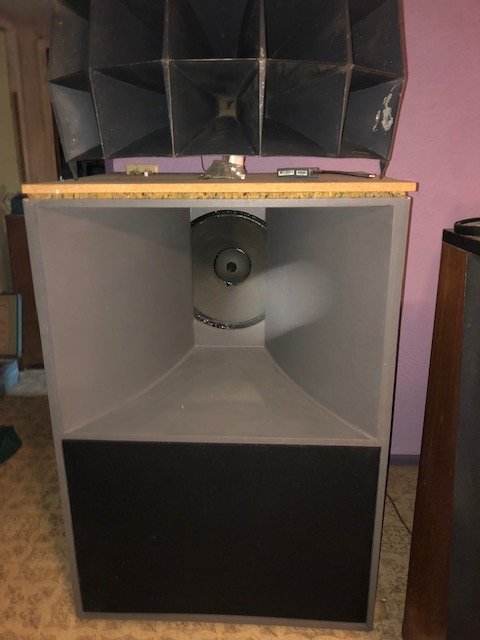

I have a pair of Altec VOTT A5's I pieced together some years ago with 288B and 515B. I have only 1 crossover N-500-C. For the most sonic pleasing display, would you build a pair of crossover networks or get another N-500-C? The Altec networks are available on ebay for $200-$500. I definitely want variable attenuation of the HF as it "takes over" with the increase in volume from Dynaco Mark III being used. Soon I will have a Dynaco ST-70 up and running. Would an electronic crossover be a better option? Thank you
Good. Now do you know of a design that's not terribly difficult for my concrete hands and won't break the bank? Say $500 or less for a pair? I'm looking for seamless integration if possible for a moderate skill level. Are my sights within reason? Is bi-amping more desirable for the best sound?
those 288's don't need much power, Put the Dyna 70 in triode for them,
Or better yet a Maggi el84 amp.you won't be sorry!
and the Mark 3's for the woofers.
If you have the room and ambition, Bi-amp for sure. cheaper older Electronic X-overs with
adjust ability X-over points, and level controls are very plentiful. Rane, Furman, Crown, Ev, just to name a few

Hello, I still have a pair of A5s after decades and in my opinion the best way is to use a DSP and bi-amp with a preference for tubes or Class-A for the 288. Trying to mount a passive crossover it can end. by being expensive in caps in addition to being more complicated for me maybe others are more comfortable with that. It is the work of adjustments and corrections that will allow you to obtain the best results according to your space.
Anyway great speakers who deserve this job!

You really want to raise the crossover frequency to around 770 hz if the speaker is being used in the home. This will allow the horn to be able to take more more power with out tearing the surround apart on the diaphragm which was a big problem when using the 500 C crossover. That was an answer I got from Don Davis at one of his and Carolyn's seminars at the ranch. He developed Acousta Voicing while working at Altec. 288C diaphragm is only rated at 15 watts RMS with a 500 HZ crossover. I would bi amp myself. Makes life so much easier and really improves the bass performance. You need a great 100 watt amp for the bottom and 40 watt amp for the horn bi-amping. I would use a 24/db octave crossover from Rane or Ashly. That will protect the 288c even more.
Or you can use a newer diaphragm which will take more power. If they were available i would use the 291B diaphragm and add two MR902- 16 HF and make it a 3 way system.

That is not beyond my capabilities. Reading the thread I referred to was wearing me out just reading it. I think my best approach right now is to bi amp with a crossover. Once I get that dialed in, I could explore DSP's. Baby steps so to speak.
I am not talking about 10 watts Full range through a passive Xover
I mean actively bi-amped on just the horns alone
At 10 watts on 288’s with any decent Altec horn
I doubt you could even stay in the same room with them for more than song
Agree!
My best results with the 288c (Altec original dia 16ohms) are with tubes amp like SE300B or PP2A3, the 300B give 8 watts and it's enough. Classe A amp is good too.
You really want to raise the crossover frequency to around 770 hz if the speaker is being used in the home. This will allow the horn to be able to take more more power with out tearing the surround apart on the diaphragm which was a big problem when using the 500 C crossover.....
Yes! the crossover set above 650Hz at least and my favorite setting was around 750
