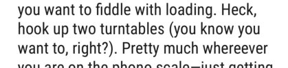

I made my initial connection with the XLRs, but didn't get to listen much. The Skoll didn't like having both arms connected (lots of ground noise). I've listened a little bit with just the XLR hooked up, but there's no easy way to compensate for the 6db change in output (unless I swap out preamps). More to come.

I wonder if sharing a ground lug is an issue. Can you ground one tt somewhere else and see if you still hear it?

I'm using a Technics SP15 which has 2 arms mounted on a custom chassis. I may have to experiment with the chassis grounding lug.
So it doesn’t have two phono inputs….are you connecting one arm XLR and the other RCA or using some switch box in between?

If the two turntables were both connected to ground (that's "ground" as in the ground wire of the mains supply) I can see there being a problem. Turntables should be floating, not tied to ground.
I have no idea if that's how your turntables are wired but that's a possible explanation.
