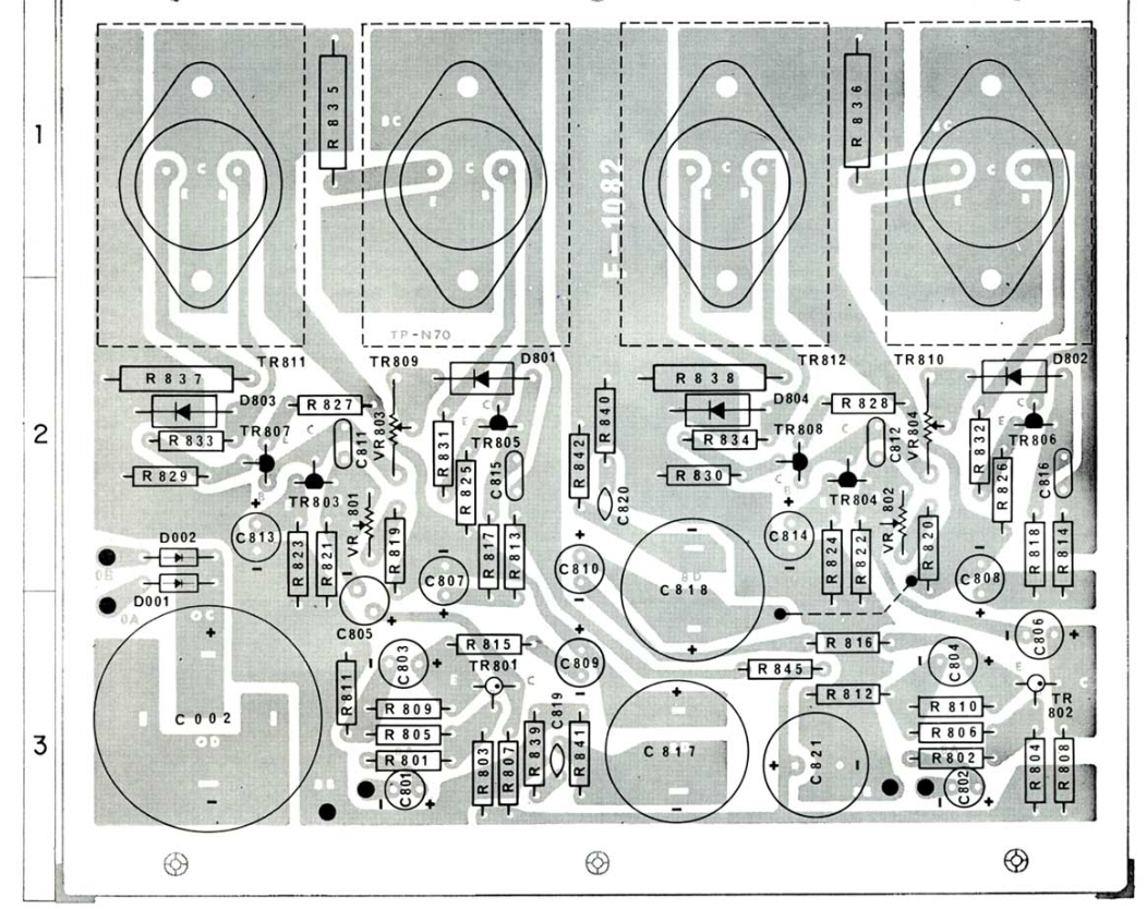

Wimas are in. Any opinions on a film cap across the filter cap?
Edit: never mind, looks like unlikely to provide any benefit. Time to wrap this up!
All done. Had a scare where the left output was scratchy, turned out I forgot to solder one of the places the main board is grounded to the chassis.
Sweet sweet sound. Might be my imagination but it sounds kinda bright. Could it be the film caps across the outputs? It's hard to tell because my test setup out in the garage always sound bright. I'll have to take it inside and A/B it versus the 2a3 SET.

Did you sub in films in anywhere else you have not before? Or it could be the the films on the outputs. Also leave it running for a day and check again. In my experience amps seem to smooth out the highs after a good burn in.
Yessir I believe in my office 222 the smaller caps are all bipolars, whereas in this one, the 1/1.5/3.3 uf are film. But also I didn't put any bypass caps on the outputs, and for some reason I suspect those might be more responsible for the relative brightness (if it even exists)...
I give mine a 12 hour burn in using 8 ohm dummy load with brown noise before listening. Otherwise it's usually disappointing.
I hooked it up to my old Sansa clip+ mp3 player with a huge library of singles. Loudness on, bass and treble all the way up, I'll let it play all day today. Do y'all just have 8 ohm resistors lying around for this purpose? Or like, a potentiometer? If so, what wattage?

I have amazon specials, 8 ohm 100 watt resistors. Use them along with a scope to check output signals. On the au222 also need to adjust centering voltage, loading is the service manual way, but there are ways around it.
Oh okay found a few on Amazon.
I was going to ask about the midpoint voltage adjustment.
I think from another amp, perhaps the 777? I learned that you can approximate it by making sure that the voltage on the 'lower' output of the quasicomplementary pair is half or slightly less than the voltage on the 'upper', but that this is problematic because you could still be 'offcenter' under load due to sag and also due to the fact that the individual NPNs in each pair don't act the same, being part of different types of circuits. I don't understand all the details but a picture comes to mind of a sine wave that is not centered at zero and therefore clipping.
So the Q is, is there a more reliable way to get there short of a scope?
My voltages are almost exactly 26.4V/53.5V.

@pete_mac I partially used your responses to a thread on a 222 restoration on StereoNet in order to arrive at these values. Any opinions on how 'bright' the 3.3uf bypass films on the output caps might make the amp sound? I might try desoldering a leg and seeing if the sound changes, and if it does, maybe try the 1uf or even 0.22uf.
I can't recall any AU-222 threads where I suggested using 3.3uf caps as bypasses - only as replacements for original electrolytics.
It's easy enough to lift a leg and find out!
Yup will definitely do that first. And I think I'll take my office 222 home to do a close A/B.
You mentioned film bypass in this thread:
