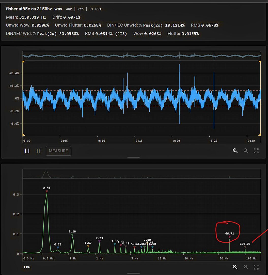

Here the plot reveals the DD players cogging at 66.7hz and 100hz transformer vibrations. And yes the cogging is audible…Note the test record eccentricity/off center has a major effect on the results
It says fisher... considering the 66.71Hz noise on the spectrum, i'm guessing this is the Fisher's 120-pole "linear" motor?

Sorry to be an ignoramus. But what does the periodicity of the blue waves and the spikes of the green graph mean?
And what is considered normal or baseline?
Thanks!
Thanks!
Periodicity of the blue wave is speed variation vs. time. The larger waves are in most cases record eccentricity at 0.55 Hz if you use a test record. Centering it as good as possible reduces it. The green plot is the spectrogram of the file so you can see both the rotational frequency of the record/platter and other issues of the drive.
