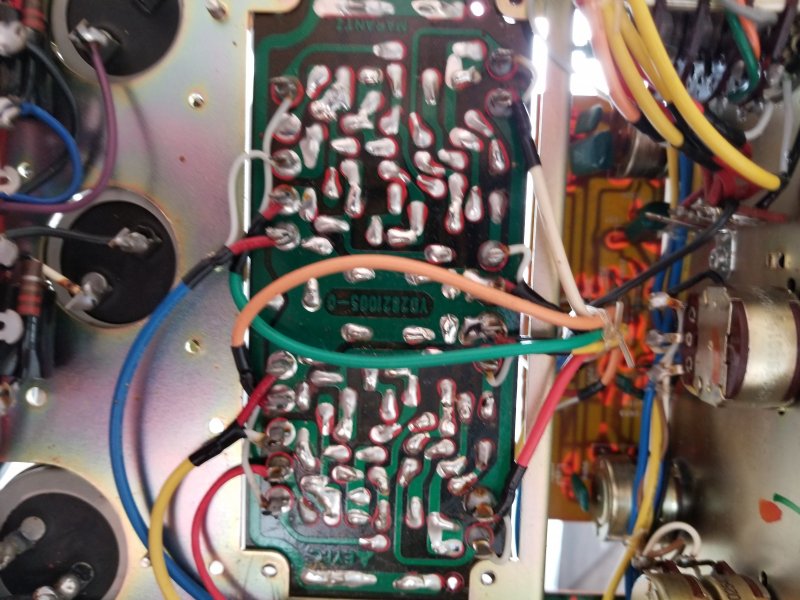

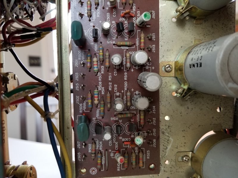

I think I've narrowed it down to noisy transistors in the preamp section. Saw that a previous poster had replaced them all with 2SC2240s. This being my first time doing this level of restoration, can someone comment on how to make sense out of this circuit board? I can't seem to make out any of the soldering points for the transistors.
Never mind. I can see why the service manual comes in handy now. Still difficult to get my head around at first. I still wanted to get other people's input to see if this would likely do the trick.
