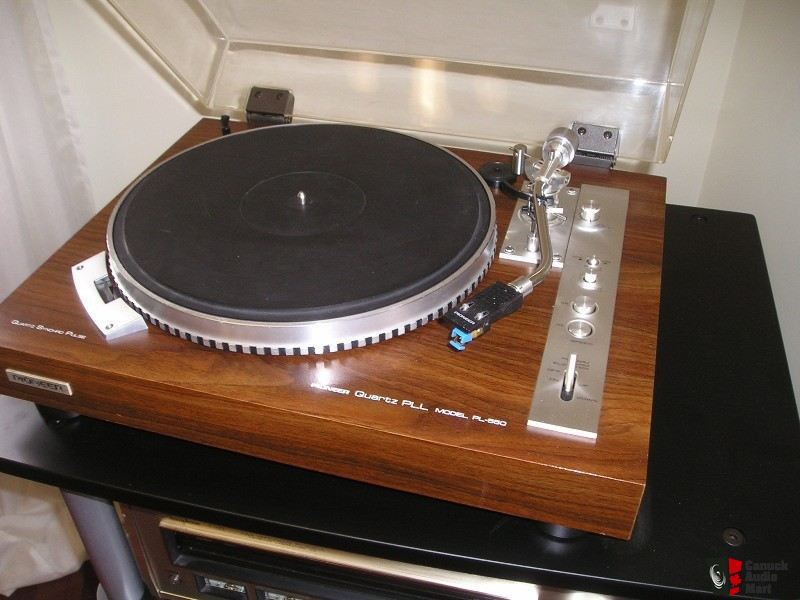

Incidentally, if anyone has any feedback about tracking down a dust cover and hinges for this beast, I'm all ears (assuming when it's all reassembled it still is a turntable and not just a pretty chunk of laminate veneered stuff)

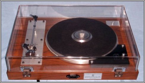

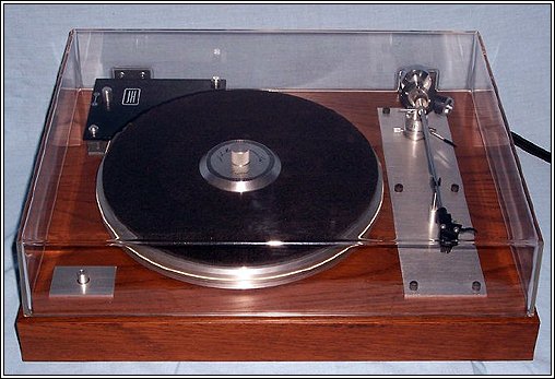

You've done extremely well by bringing an item that was probably destined for the trash back to life. Beautiful reincarnation I call it.
I feel you are going to have a real hard time obtaining a lid assembly. I bought one back in the 1980's brand new from our local Pioneer spare parts stockist for a TT that I was building and as such I based the plinth size around the lid itself. This JH table (Aussie designed) was loosely based around the looks of the PL-550 which I really wanted and liked back then, but just couldn't afford. The wood grain veneer is genuine Australian Oak and not vinyl, but you'll see the similarity in the colouring to the 550.
I still have that table packed away as it's a bit of audio art that I'll never sell due to it being a combined effort between a good family friend that passed away many years ago and myself.
Below are a couple of shots of it as it appears on a website here in Australia.
and a slightly manipulated shot from the rear.
And below is the table it was based around.

I hope it helps! FWIW too, if your friend doesn't have the dust cover and hinges (which are crazy expensive unobtanium), I found from another thread you can replace them with the dust cover/hinges from a PL-A35 - credit goes to @kapohoguy in this thread.
I'll pop a pic up later, my PL-A35 cover and hinges arrived and got installed over the weekend. Works great. Looks great.
