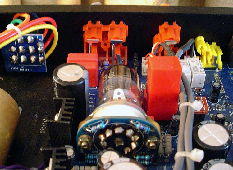

Ahem ... presenting for your edification and pleasure tonite, (drumroll please) the Burson v5 ...
Thankyewverymuch! <G>
The red tower ... That's in my Maverick D1+. I also upgraded the headphone amp and I/V conversion with OPA627's mounted on Browndog adapters. You can see one of those peeking out next to the Burson v5.
Let's not forget the other end of the cable ... I upgraded the HTPC with a Paul Pang card.
That has it's own power supply (the card itself will draw 1 amp!) and creates it's own "audiophile grade" USB channel. Only thing plugged into that is the DAC and ADC so it's fully isolated.
Not to forgot the cable itself. That's a Pangea 4% silver, which is a pretty decent step up from the run of the mill fare.
These changes had some real serious impact on what I'm hearing - night and day at least - and it takes a good 200 hours to get it all to break in properly. About halfway there and still getting an occasional wOw moment when something else clicks in yet another step towards audio nirvana! Me like!!
