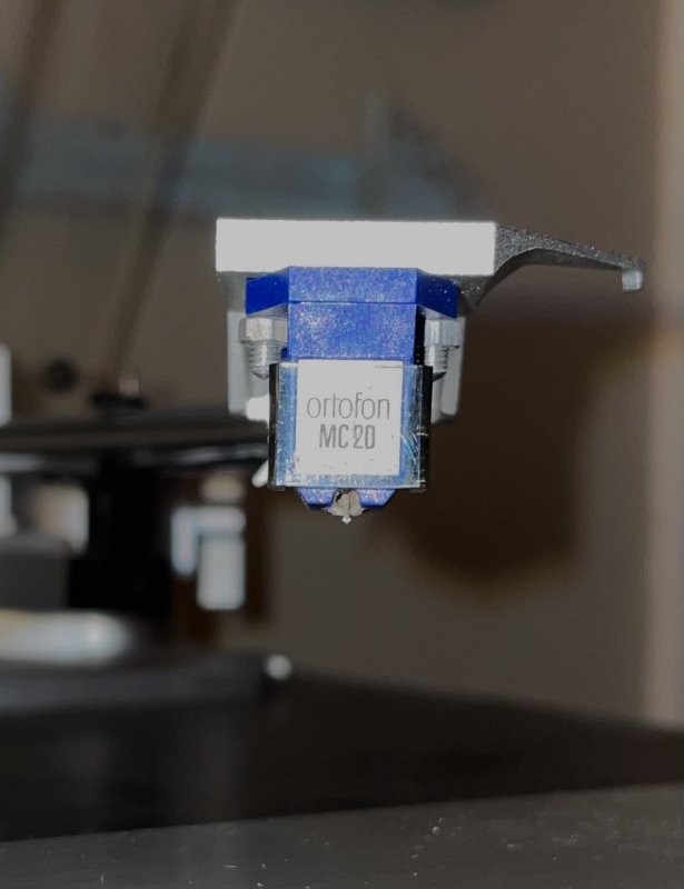

@rothwellaudio i am not sure the version I have. I would assume it’s the one with very low output. How would I tell?

... i am not sure the version I have. I would assume it’s the one with very low output. How would I tell?
Take a photo of yours? This is the original with 70uV output.

My MC-20 is the original. It does not have any other words after MC-20.
It is the exact one that @HalfApt posted above.

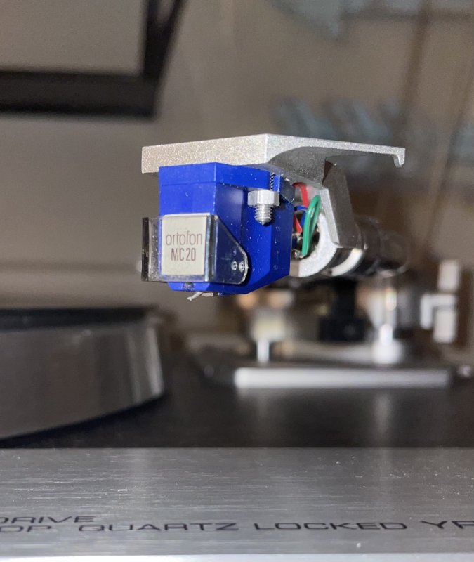

Also, if I post a picture, would you be able to tell the condition? Or is that a in person analysis?

...Also, if I post a picture, would you be able to tell the condition? Or is that a in person analysis?
It looks good generally, but the the diamond stylus (the most important part) can only be judged by a trained eye under magnification. With an unknown condition stylus, it might be worth trying to get it inspected before spending more money on SUT or head-amp.
