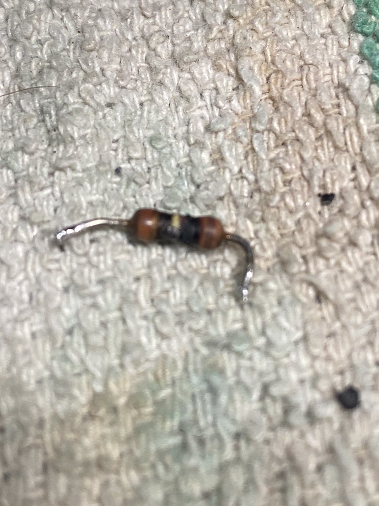

I also found a cooked resistor but it measured ok but I replaced it anyhow.
R712

Burned resistor means something connected to it is defective. A resistor never burns all by itself.
Oh, forgot to mention C706 leaked its guts , it's connected to R712. I bet that did it.

BTW, R705 in your picture also looks smoked.
