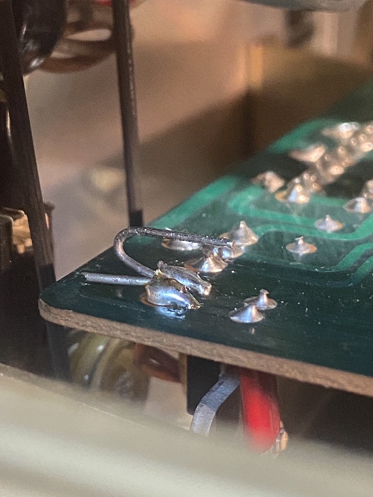

I removed the Tacho sensor and it was pretty dirty. Then I demagnetized it and reinstalled it. I then loosened the one screw that also had clip that looks like it might be used for some sort of GND scheme. I then put a mica insulator between the sensor head and cog wheel.
At first it did not do any thing then after a short time it ran properly. I switched back and forth between speeds and also many cycles of power off and on and also lifting and dropping the end of play off arm. Speed change works great.
I reinstalled the capstan board and left the old resistor leads I added to measure the Tacho , so I can use them to measure the sine wave in the future if need be.

Hoped connecting the scope probe would do what it did before( causing speed to become correct) but nothing. So I also wanted to see if there was voltage right at the sensor head. I had voltage and changing the speed button did nothing. Poked all the relays ( Is one for the speed? Couldn't figure it out on the schematic) and nothing. So I went to check voltage right at sensor head and speed went to normal, but as soon as I removed the Hand held DMM probe from the sensor it sped up again. touching probe slowed it down again. After it has been on for a while it seems to hold steady without touching the probe to sensor .
So it seems it may be warm up related. not sure where to look for cold solder joints, that is which board. It have to be one that would heat up after being on for a while.
EDIT: After letting it run for some time the speed went up again and now nothing I do adjusts the speed.
I wonder if the Tacho is intermittent?

DID you take an ohm meter across the head itself? What does it read? Deck OFF!!
the day before it read IIRC 515k . It wasnt OL I know that for sure.
I'll check when I get home. I was thinking to re check it anyhow after last nights behavior.
nashou
That's kinda high.... Usually around 200 or less.
Ok I desoldered one lead to the sensor and got 3k finally . At first it was jumping around very high then lower and lower. I tried a couple DMM's all did the same.
