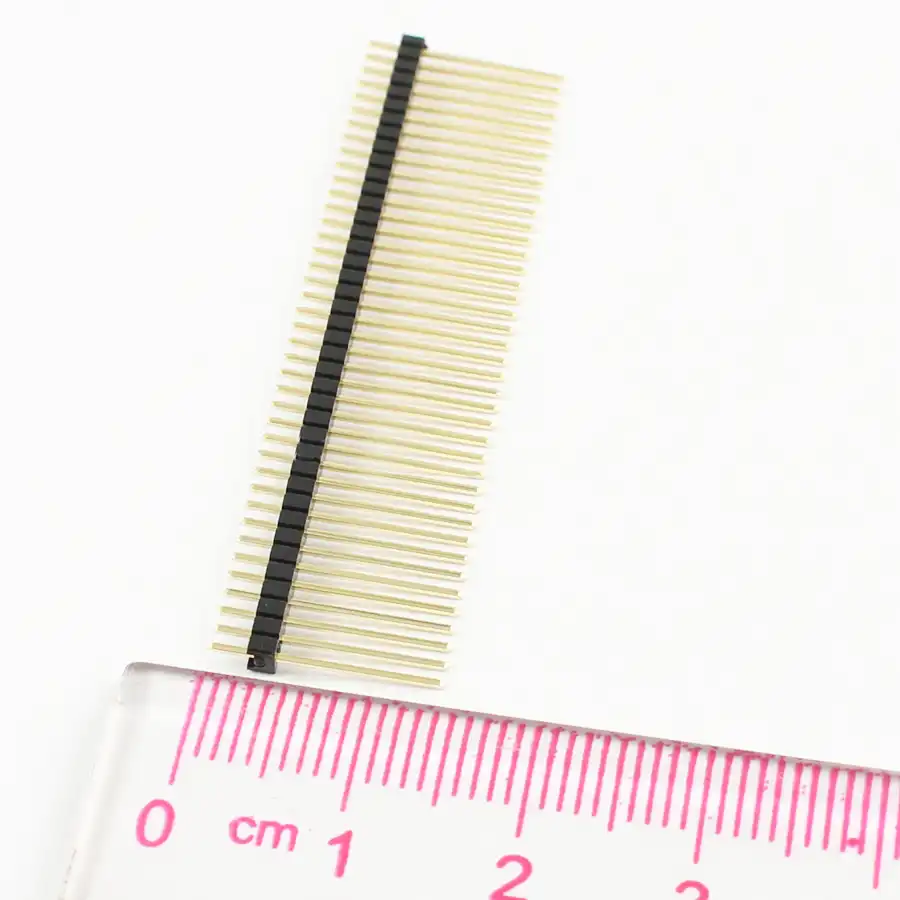

If the new board kidna hangs off the side too much, we could use those long 0.1mm headers to it would sit above the other parts. like these
