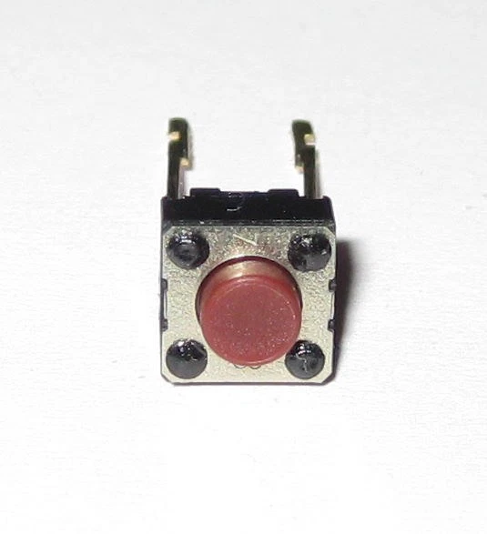

I've made a fair chunk of money fixing broken/lifted traces on PC boards over the years. Most of the damage was due to too much heat for too long when someone with bad soldering skills tried to "fix" something. But other times it's just abuse.
One of the extreme cases was on a JRC NRD-525 Shortwave receiver. I bought the radio used in 1987 at Universal radio. It was only about a year old.
As time went by, it was sold to a friend, who sold it to another friend. One day, he calls me and tells me that the keypad keys have pretty much all failed. He's all upset, thinking that the 10 year old radio was "worn out". I thought, "Huh? How is that happening?". The keypad are literally metal shells put over the switches shown below, and basically are bulletproof. Like these switches:
So I take the radio, and the PC board behind the keypad was just trashed. Cracked PC board in a couple of places, about a dozen traces broken or coming off the board, and it's just a mess. The board wasn't very thick, and the traces were pretty narrow and the flexing just wrecked it.
Since I knew the two owners previous to him had no issues with it, I knew he had to be the one who damaged it. I decided to replace all the keypad switches, they were really cheap, even for the "genuine" JRC ones. I ordered them, and while I waited for the switches to arrive, I wanted to see how he was pushing the keypad buttons when he used them. I met him somewhere and he was pressing them almost like he was angry, and I said, "Why the hell are you pushing them that hard?", and then very lightly tapped on them to show him the pressure he should have been using. Once he saw how insanely hard he was pressing on those buttons, he understood he was the cause of all the damage. Between some epoxy, one of those trace rebuild pens, wire and crazy glue, I fixed all the damage, and I guess I did a good job, as it's lasted well over 20 years. My only regret was the price I gave him to do all the work. Oh well.
